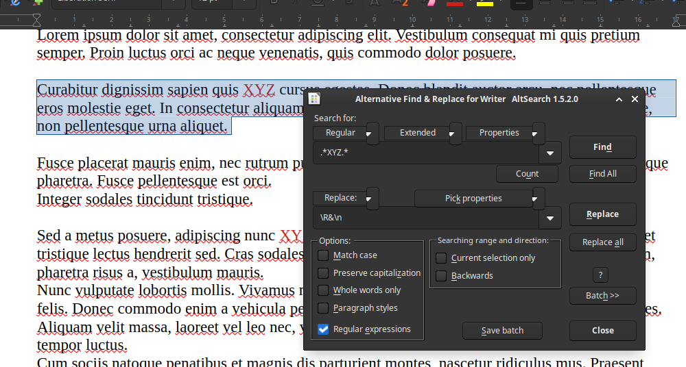

this can be done with altsearch extension with the \R trick on regular expression Replace All,
e.g.
see embedded help for details on redirection.
