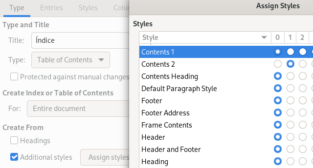

Do not create the ToC from “Headings” but from “Additional Styles”. There you can select which Heading style is shown on which level in the ToC. Thereby 0 means, that it is not shown at all.

Oh, I see. ¡That’s great!
imagen
Edit Index (right click on TOC)
