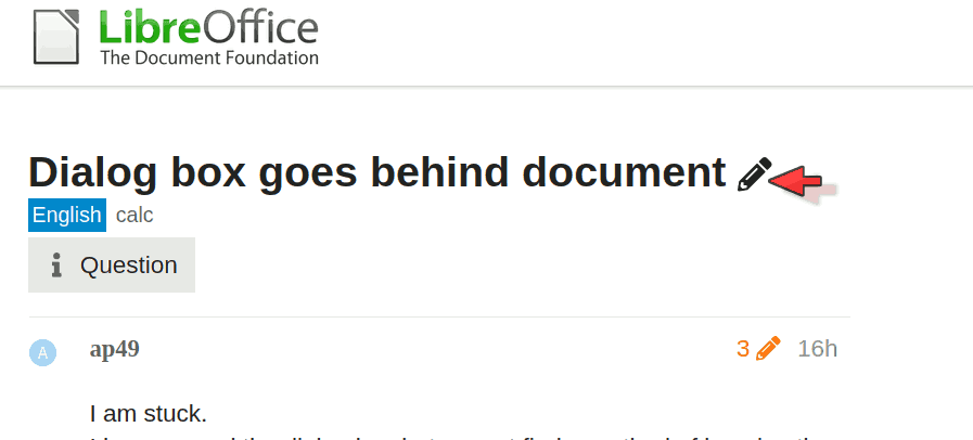

I think you must to change your theme tag from Calc to Macros
Thank you for your help. I have now posted it to macros and calc, I hope?
Try this pencil:
