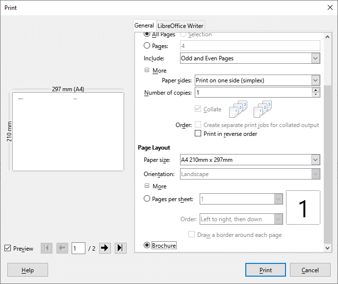

in draw print dialogue: brochure print: there is no right to left option like in libreoffice writer?

this is not brochure print

but in draw:
I suppose that is an option for the texts written in right-to-left direction, but not for the pages in a Brochure printing task. Maybe some positioning (margins?) are different in the texts written in right-to-left direction…

Yes, I see now: there is in that version of the Writer (I just checked in my portable 24.2.2.2 version). And there is not in Draw.
I think reversing the order of the pages would give the required brochure, so instead of having the pages in the Pages pane in the order 1,2,3,4 if they were instead 4,3,2,1 then the brochure should print correctly for RTL. Test with sample below.
