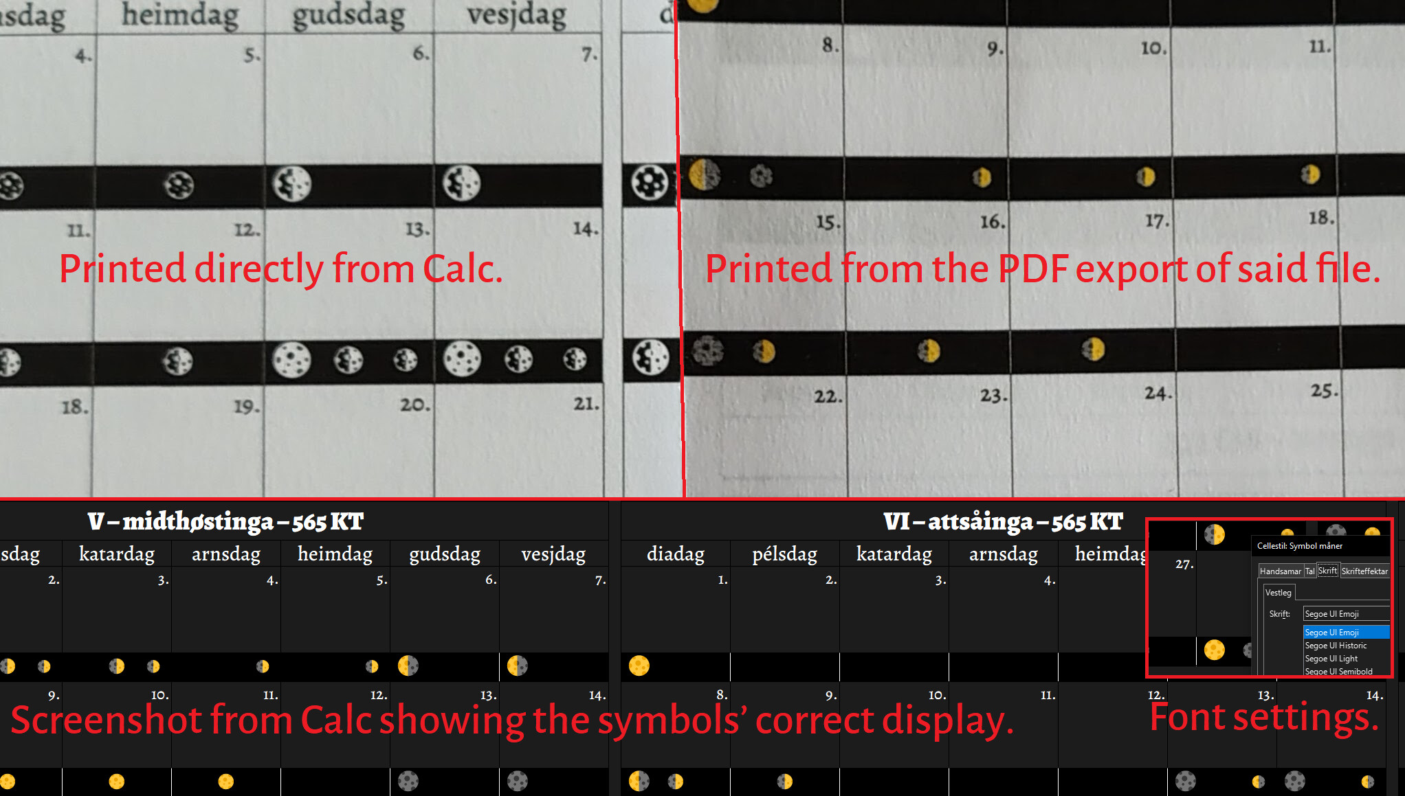

bug. In my document, a calendar, I have Segoe UI Emoji selected for displaying the phases of the moons (RPG setting). It displays correctly in LibreOffice Calc 7.6.7.2, and exports correctly to PDF, but when printing the document directly from Calc, the symbols are replaced by monochrome symbols, unlike the PDF printout.
Hi @CannedMan, it’s set up for color printing.
I can confirm, if you are using Windows then it looks like Bug 168412 - Color emoji fonts (e.g. Segoe UI Emoji) print only in black and white in Writer – no color output
ColourEmojisPrintBlack.ods (14.1 KB)
BTW On my wife’s Microsoft Excel 2019 the emojis from Segoe UI Emoji appear black and white as well as printing black and white.
See also Emojis lose color after exporting from .docx to .pdf - Microsoft Q&A
