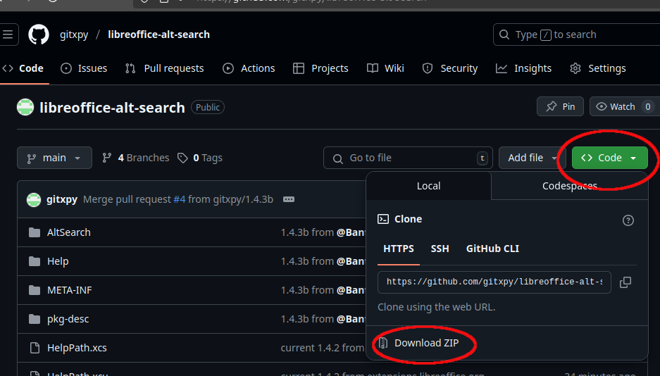

so, let’s go with GitHub - gitxpy/libreoffice-alt-search
I have initialized it with current 1.4.2 from extensions.libreoffice.org,
then merged the changes from @bantoniof 1.4.3b

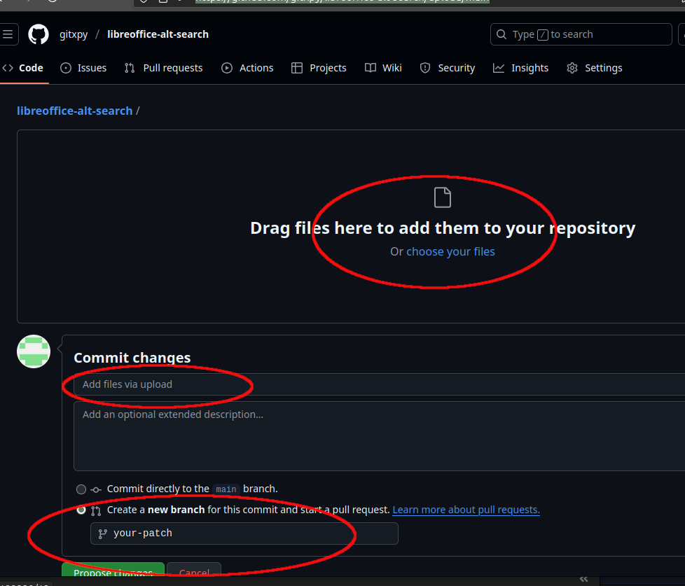

To minimize the learning curve, you can get the files with a simple download :
then submit changes by dragging your directory back to Upload files · gitxpy/libreoffice-alt-search · GitHub
Feel free to try and ask assistance if needed
