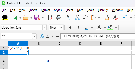

Or use TEXTSPLIT appeared in 25.8:
=HLOOKUP(10;VALUE(TEXTSPLIT("1,2,7,11,15,20";","));1)
Fails with #N/A when using references: =HLOOKUP(B4;VALUE(TEXTSPLIT(A1;","));1)
Works fine here. Are you sure that 10 in B4 is a number?
why HLOOKUP instead LOOKUP?
I was missing the call to VALUE.
Doesn’t matter. Both are equivalent.
yes…but HLOOKUP needs an additional Argument.
