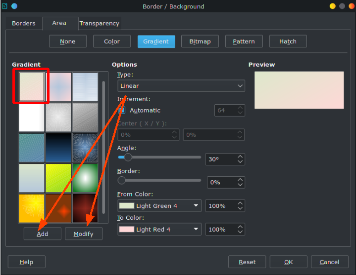

Hello
probably you missed to Add your gradient definition or to Modify an existing gradient definition:
  • make the gradient definition
  • click either Add (creates a new gradient definition/tile in pane Gradient or Modify (changes the currently selected tile in pane Gradient )
(I admit that this is a bit twisted and one would expect that changes get applied just like they have been made)
**Ref.:** [LibreOffice Help - Creating Gradient Fills](https://help.libreoffice.org/latest/en-US/text/sdraw/guide/gradient.html?DbPAR=DRAW#bm_id3150792)
Hope that helps.
