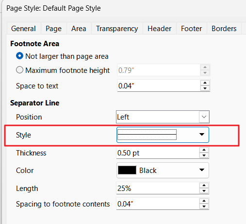

Note separator
The note separator is defined in Footnote tab of a page style. You can suppress it by setting Style to None.
Personally, I would eliminate the top border you added on Footnote paragraph style. If you have several footnotes in a page, separating each footnote with an horizontal line results in a strange layout (but this is personal taste, YMMV).
