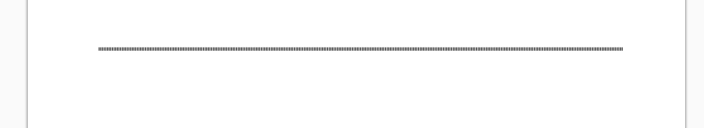

Full page black horizontal line made of small vertical dashes
I have encountered these full page black horizontal line made of small vertical dashes in Writer, I cannot understand it completely and/or remove it.
It seems like some kind of break, but I cannot edit/access it vi right clicks or anything else. Selecting the line, even together with one line above and one bellow, does not remove it as well.

Here is an image of it:

The paragraph has a 3pt-thick bottom dashed border.
It can only be suppressed with Format>Paragraph, Borders tab.
