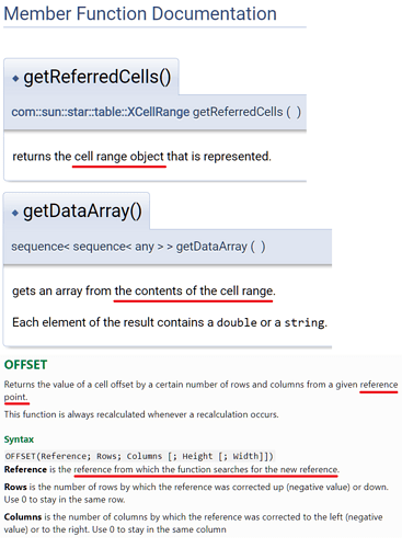

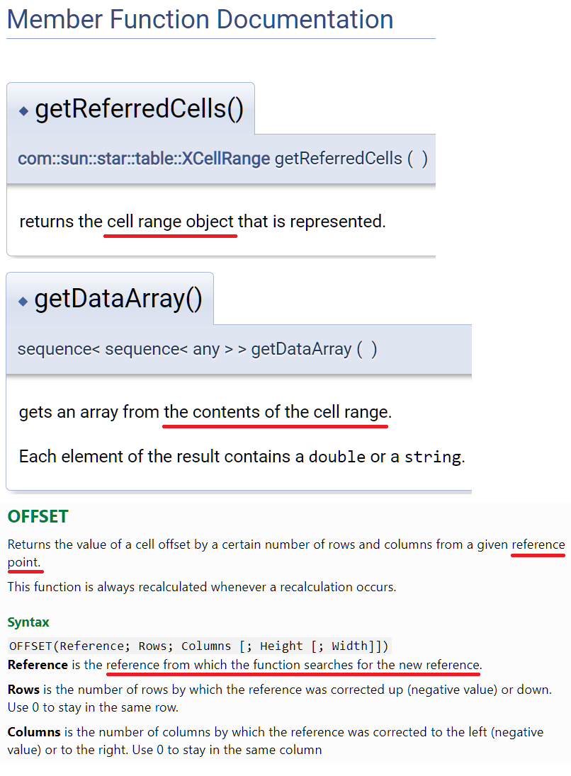

It seems as if you don’t understand how “offset” works?
The first argument of “offset” is passed to the function by Calc as a “cell object”.
Otherwise, I see your “UDFs” as nothing more than an unnecessarily complicated replica of:
=INDEX( whole_range ; MATCH( …the_row…); MATCH(…the_column…)

On your cell object comment. First I assume you are referring to Libre Office Basic not Calc. Yes it occurred to me that the function might want an object containing cell references, not values. In fact this was the first thing I tried: ThisComponent.NamedRanges.getByName(sRangeName).getReferredCells()
as the first parameter in the call. It failed and after looking around on line that evolved into what I’m using now: ThisComponent.NamedRanges.getByName(sRangeName).getReferredCells().getdataarray() which seems to work in the first two functions.

If the problem is that offset wants addresses in the first parameter, it seems like both functions would have the error. (as they both are initialized with the .getdataarray()) But I did try it without the .getdataarray() initially and this generated errors also (in both functions). These errors went away in the function that is working after .getdataarray() was added, but remain in the last function.
at least since LO-version 25.2 any of them is available!

To be honest, I immediately saw the mistake, it’s simple, @karolus was trying to tell you about it.
I asked for a sample of the data because I was interested in this point:
I just don’t understand how this could work, I was hoping it was some unexpected effect related to defining a named range and the data in it. What can I do, I still believe in miracles.
As for possible sources of errors - don’t worry: here, on this resource, completely incomprehensible problems have been described more than once, which after careful study turned out to be, for example, a buggy clipboard manager or the absence of a printer driver (what I called system settings in my comment), or a long-known error recorded in Bugzilla. So I simply stated in general, without reference to your specific problem - errors can be different.
