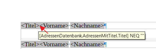

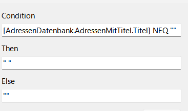

A conditional space after the title is sufficient for me.
2025-12-05 08 37 38
2025-12-05 08 33 12
