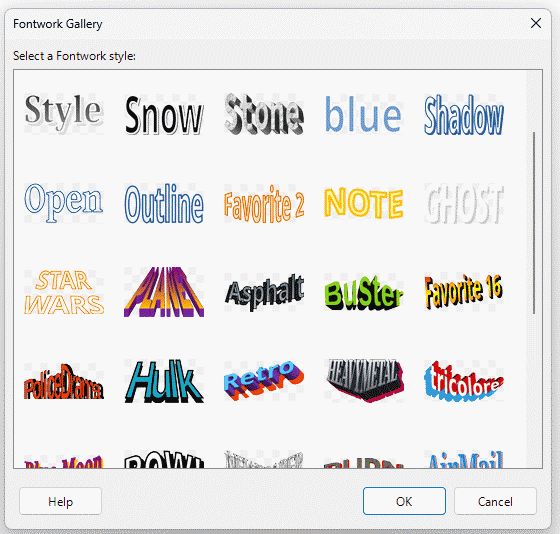

…or do you need the Fontwork feature of the Impress?
