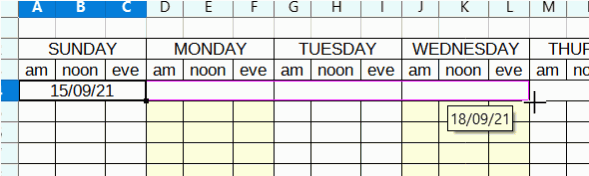

How do inserts a series of dates into a merged cells.
Row4 is where I need the dates to be. The cells below are “check-off” points.
I need to add the dates for Monday - Saturday, I just want to add as a series input,not to be inputted one date at a time.

Click and drag from the bottom right corner of your date (indicated by small round dot in image).
DragDate

That will not work for it gives the following results in each cell before the merge:
09/09/21 09/10/21 09/11/21 09/12/21 09/13/21 09/14/21 09/15/21 09/16/21 09/17/21 09/18/21 or display as:
That’s why you see 18/09/21 at the end
@_dave Only works from version 7.1

BTW your file starts at 15/9/21 so plus 3 cells = 18/9/21. But then I am using 7.1.5.2 which @PKG has pointed works OK for filling merged cells.
Not using merged cells in spreadsheets, I didn’t even know it was a problem. I did see that Sheet > Fill Cells > Fill series doesn’t work as expected and thought that was what you were having trouble with. Anyway, happy days again. Cheers, Al
PKG- thanks for the “solutions”, I found out that my version was 6.4 (Linux Mint is a LITTLE behind time). Just now downloaded 7.2.1 and I will upgrade tomorrow and follow up.
