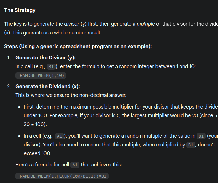

AI says :
(2,10) would be more interesting :wink:
  • More interesting to us? Probably!
  • More useful for a problem set? Not in every setting!
    On some educational levels, the concept of “divide by one” is also important to convey. It is not intuitively grasped by every student.
Do you really want to keep posting screenshots of AI prompts, instead providing Answers by your own?
well,at some pt, soon, no one will ask here :wink:
pasting the text doesn’t show up properly; need to check how gemini can share links.

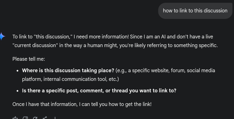

Ask your friend:
chicken&egg :laughing:
To link to “this discussion,” I need more information! Since I am an AI and don’t have a live “current discussion” in the way a human might, you’re likely referring to something specific.
Please tell me:
Where is this discussion taking place? (e.g., a specific website, forum, social media platform, internal communication tool, etc.)
Is there a specific post, comment, or thread you want to link to?
Once I have that information, I can tell you how to get the link
but doable : https://gemini.google.com/share/4a7606b63cff
