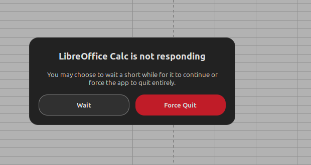

Is that LibreOffice, or your OS?
Does that actually stop processing, or if you let the message stay, it will eventually succeed?
What is the macro language?

When Windows shows a “not responding” dialog, its title mentions the hung application, not Windows. Without a screenshot, hard to tell. I don’t know which code in our codebase would do what you describe, so I doubt it’s LibreOffice. (and the OS is still unknown.)
It’s linux mint and this is what it shows when it stops.
How do I do this? Note I’m completely new to Linux.
