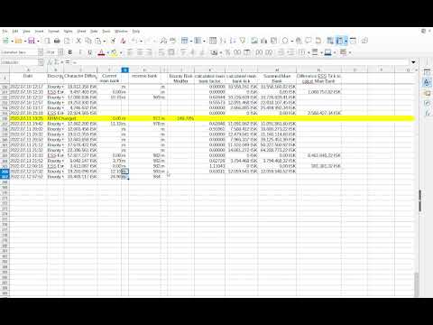

Hi,
I have s spreadsheet where I populate the first cells in a row with a copy/paste.
Then I have some more cells with formulas that use that data, but I have to pull them down by hand for each new row. (see video below for example)
Is there any way to automate this process, so that I only have to copy paste the data, and the rest or the row automatically pulls the formulas from the above cell?

I didn’t watch the video, but created a simplified solution based on my understanding of the question. See attached proof of concept.
copyFormulasIfDataComplete.ods (18.0 KB)
Thank you, I had a look at the macro, I think this will help me write my own custom macro to solve this.
