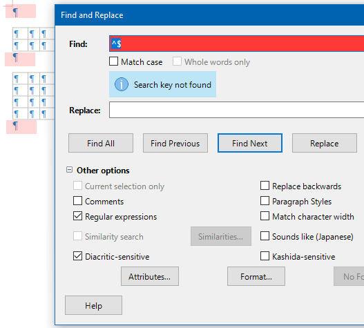

I want to change the “Default Paragraph Style” for another style in the empty paragraphs* (that exist between, and before and after tables).
Does anyone knows how to find them all?
I tested with ^$, ^, and $ [and $^].
Thanks in advance.
File to test with:
empty between tables.odt (8.5 KB)
* With red in the screenshot, screenshot edited.

i don’t think you can do it with standard F&R. You can find empty paragraphs with ^$ but there is no “descriptor”/keyword for a table. And anyway the scope of standard F&R is limited to one paragraph. Since tables are “objects” they are external to your intermediate paragraphs and can’t be matched even if there were a keyword for the tables (because they live outside the paragraph).
I’m not looking for tables, just empty paragraphs (that exist between tables).
I reworded parts of my question to clarify.
Strange: I used ^$ to find empty paragraphs and it does not work here. LO 25.8.3.2.
If I add any character (single-character paragraph), ^.$ works but ^.?$ does not find the empties.
I think @ajlittoz is right, and I’m afraid also AltSearch has no means for the task.
You will need user code.
