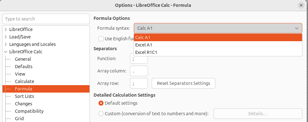

Please see what value you have selected for this option

I’m set to Excel A1
It’s more complicated than that.
You’ve got to click the custom settings, then [Details…] and “Reference syntax for string reference” = “Calc A1 | Excel A1” which interpretes Sheet!A1 and Sheet.A1 in the same way.
that seems to have nailed it!
thank you!
