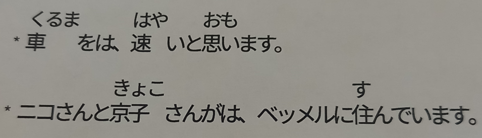

My default font for Japanese texts is Noto Sans Mono CJK JP. While entering text the different kana are separated by some space. But when printing the same text to paper, there is no space between the kana (kerning = 0). Western fonts give no problems.

I have attached an odt, a pdf and a photo from a print. The photo shows only the bottom lines.
