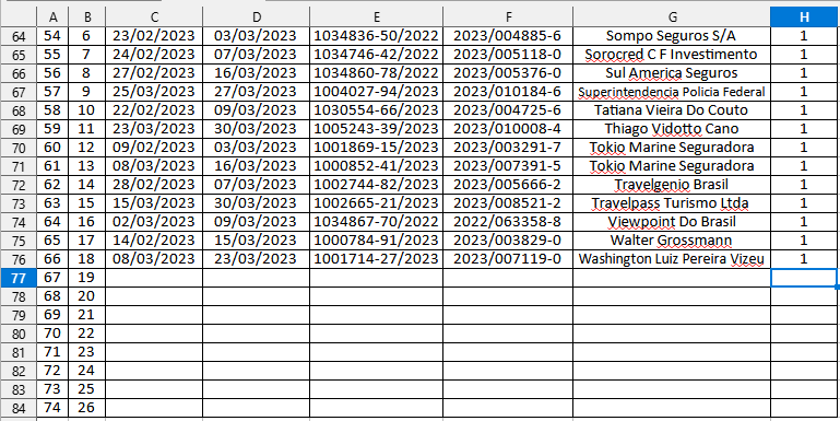

Last cell with data (but not space)
I have this spreadsheet
There is a space in cell H83
If I write the macro code
Sub CheckLastRow
Dim oCursor as Object
Dim LastCol, LastRow as Long
Dim lf as String : lf = chr(10)
Dim oDoc As Object : oDoc = ThisComponent
Dim oSheet As Object : oSheet = oDoc.Sheets.getByName(“Gratuita”)
oCursor = oSheet.createCursor
oCursor.gotoEndOfUsedArea(False)
LastRow= oCursor.RangeAddress.EndRow
LastCol = oCursor.RangeAddress.EndColumn
msgbox LastRow & lf & LastCol
End Sub
I get this message
The question is…
How do I get the last cell with data only (not space)?

The last cell used on spreadsheet…in my case it would be H76.

The cell H83 has space only…not data.
The cell technically is not empty …It has a string
