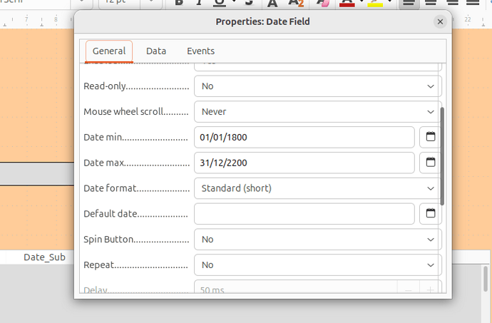

Remove any default value from the date control properties.
I’ve managed to upload screen shots and “think” i’ve uploaded the test database.
I’m not aware of any “default value from the date control properties”.
There’s certainly no default value for date.

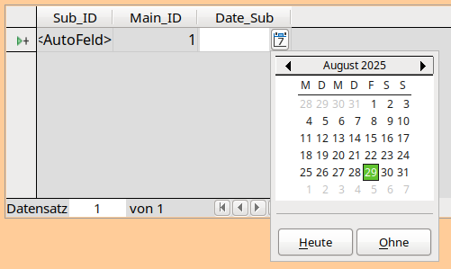

That is what I see here:
grafik
System: OpenSUSE 15.6 with KDE desktop
LibreOffce Version: 25.8.0.4 (X86_64)
Build ID: 48f00303701489684e67c38c28aff00cd5929e67
CPU threads: 6; OS: Linux 6.4; UI render: default; VCL: kf5 (cairo+xcb)
