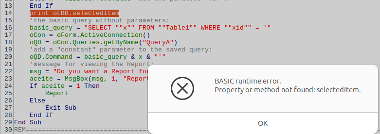

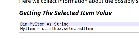

I tried .selectedItem without and with parenthesis.

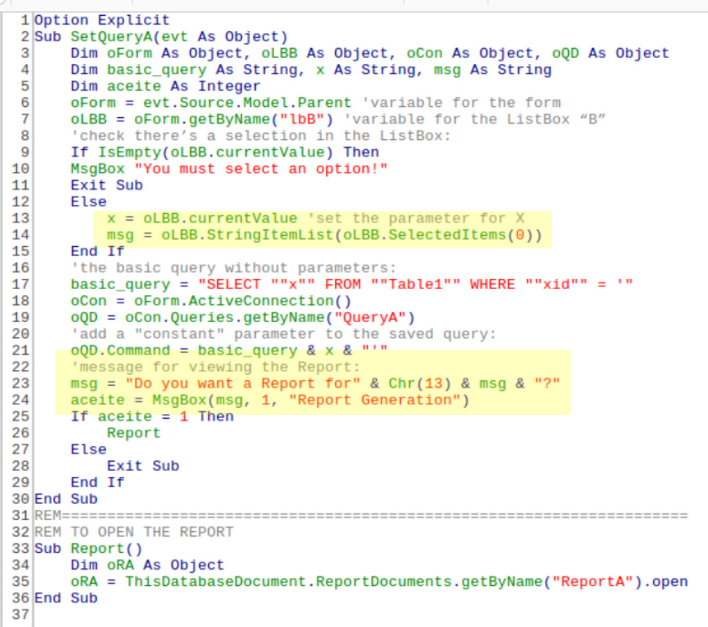

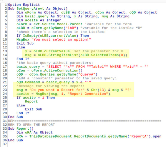

You could try it directly with
SUB ListView
oField = thisComponent.Drawpage.Forms(0).getByName("MyListbox")
stView = oField.StringItemList(oField.SelectedItems(0))
msgbox stView
END SUB

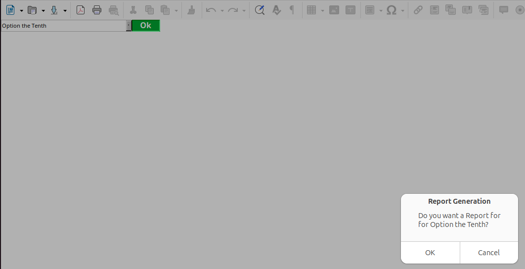

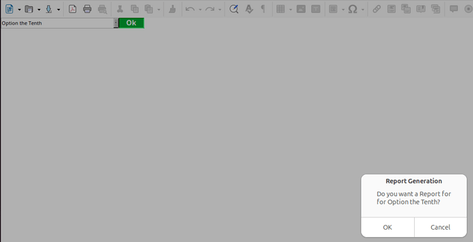

Yes, it worked.
Thank you.
