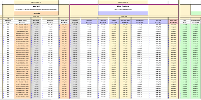

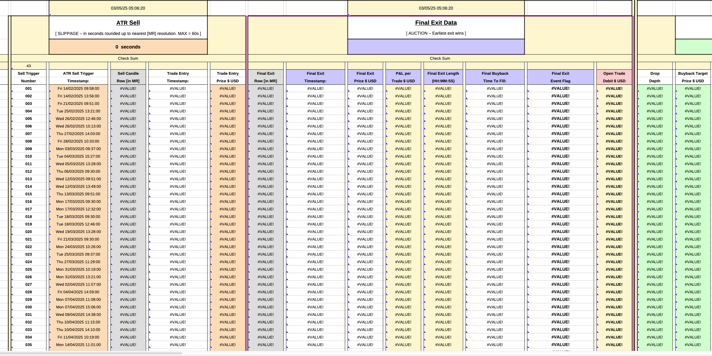

I’m starting to wonder if the problem I’m having is related to some kind of internal memory overload, possibly related to the number of Undo’s?? LET caching?
Is that possible?
My attached screenshot shows the state of my sheet right after I made a simple delete of a number in a dashboard cell, that at the time, was not even controlling anything.
It was just a layout placeholder I was playing about with, so I don’t see how it could force any formula to “panic”, but that seems to be what happens randomly all the time.
I’m confused
Help!
CT
