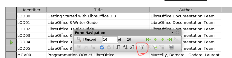

How to filter a form using the built-in tools:
  • Click the icon with the magic wand on the navigation toolbar. This filters by the value having the focus.
  • Click the icon “Form based filter”, enter filter criteria into the form and click the “Apply” button on toolbar “Form filter”.
  • Click the last button on the navigation toolbar, which opens another grid view of the form, then the “Standard filter” icon above that view and fill out the filter dialog.
This is documented in more detail and with screenshots in the Base Guide, chapter “Searching and filtering in forms using the navigation bar”
Apologies in advance, but I just can’t locate the magic wand icon.
Sorry!

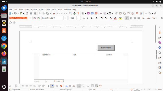

• Form in edit mode (ok)
• Design mode (ok)

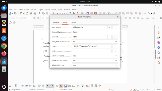

Ok, so that’s the form’s Filter property on the Data tab?

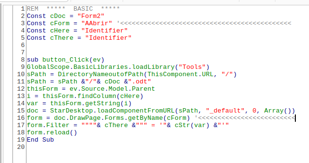

Since 14 years I write SQL and macros for @Dreamquartz who has strange ideas of database usability.
@Wanderer and I stated, the whole idea of opening another form document would be nonsense, unless you have no more space left on screen.
Anyway, @Dreamquartz tries to apply a filter on some integer field in another form document.
He was unable to implement my suggestion Open a different form with a pushbutton, with content based on the sourse - #7 by Villeroy because he is lazy and unwilling to learn anything in depth and detail.
My sample uses the “Bibliography” database, since this is the one we all share having a default installation of LibreOffice.
The “biblio” table of that database consists of strings only, which makes a subtile difference. I added a note to my sample:
P.S. because the “identifier” in the biblio table is a string, I had to wrap the variable in single quotes.
He ignored this note, started his usual trial-and-error game and failed.
Property “Filter” is an SQL expression. After all the years, he does not know the meaning of quotes in SQL.
I became reluctant to post the straight solution and gave a hint, how to reveal the correct SQL string for the form’s filter property set by the macro (apply the filter manually, and look at the filter property).

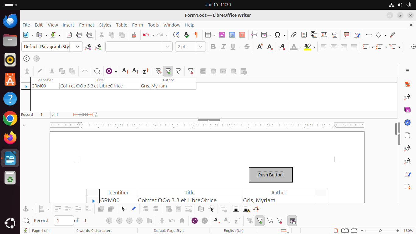

Got it!
Was somewhat confused because both forms are named “Form”, so changed Form 2’s name to “AAbrir” (ForOpen).
