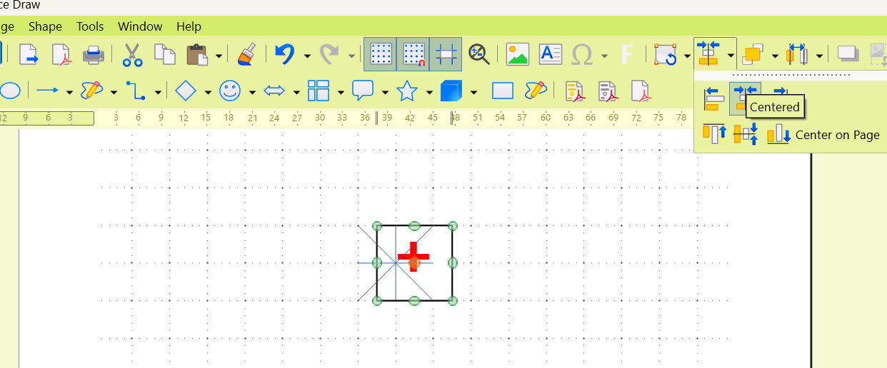

So I am trying to find an explanation as to why this is happening. I noticed that there is even a bug report about this from months ago, which received no attention at all — 164240 – Exported PDF doesn't take "Spacing to Borders" into account properly
Misaligned_plus_test.odg (10.8 KB)
As you can see, after you export the document as pdf, the plus sign goes off center for some reason. I tried to check every setting and I still cannot understand why this is happening.
Perhaps because they are not centered.
Select those drawings and, using the alignment tool, center them.
Nope, they are centered. I re-tested it.
Even if they weren’t, why should the pdf file move them anyway.
Maybe I am missing something obvious here. I hope someone figures this out.
After centered, the rectangle, has a different position.
Oh, I thought you mean centering the text inside.
I still don’t get what the problem is, though. Centered or not why does the pdf make a change to the file?
Right before exporting I make no changes to the .odg file and it is right in the center, after export it changes…

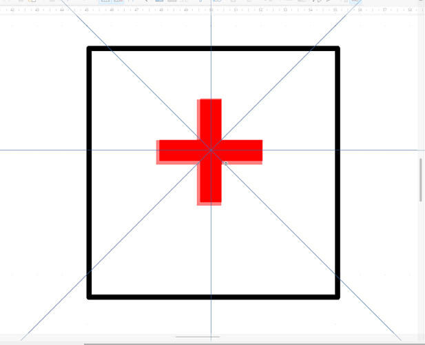

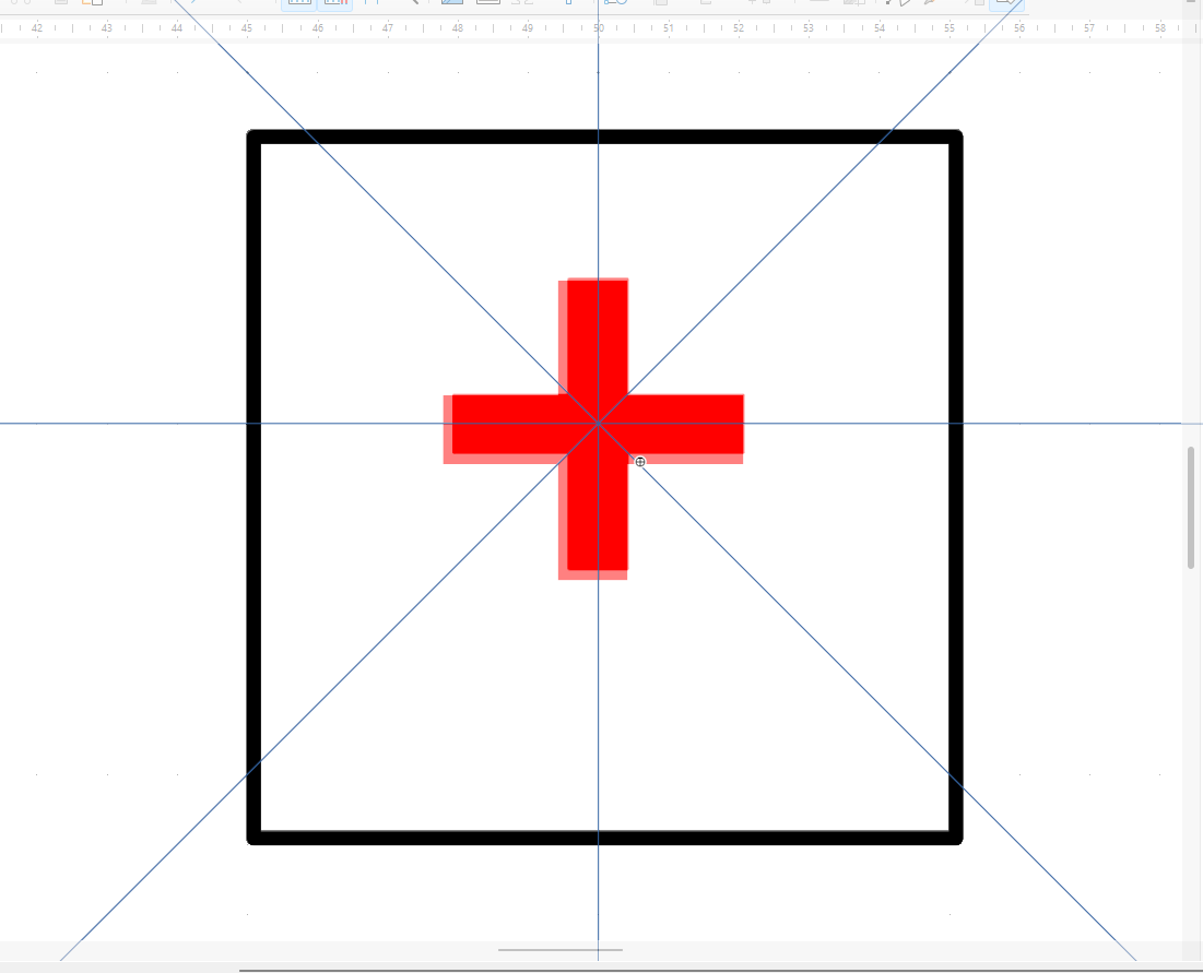

If you screenshot the zoomed-in view (with identical zoom, say, 1700%) in Draw and in a PDF viewer, and overlap them (with partial transparency), you may see that the difference is in the text size. See how the text’ top right ~coincides, while left-bottom is considerably different.
(I screenshotted my slightly changed document, not exactly your example.)
In this case, why does the PDF change the text size? Why can’t it keep the exact same size?
