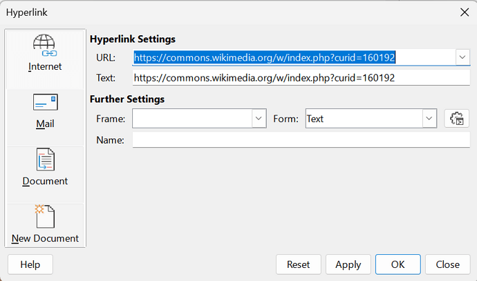

Using Writer, I have a master document with over 800 sub-documents. Many of the sub-documents contain hyperlinks, urls to various pages on the web. If I export a pdf from a sub-document, the hyperlink in the pdf file works as intended; click and the link is executed. However, if a pdf is created from the master document, the hyperlinks from the sub-documents work only if the Text field contains the actual URL:
If the hyperlink in the sub-document contains any other text in the Text field, such as “Click here”,
the text “Click here” shows in the pdf file from the master document but is simply underlined and in blue; it does not function.
Again, if I create a pdf from the sub-document alone, all hyperlinks in the subsequent pdf file work as expected, the problem is in a pdf created from a master document IF a sub-document contains a hyperlink having other information than the actual url in the hyperlink “Text:” field.

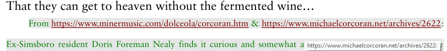

In testing I did discover another oddity: on one line in a particular document I have two hyperlinks both of which are referred to without text:
The oddity is that the second link works as intended and the first link does not work. Up until now, each time I was using a link which showed the full URL, the link would work. Curious.
