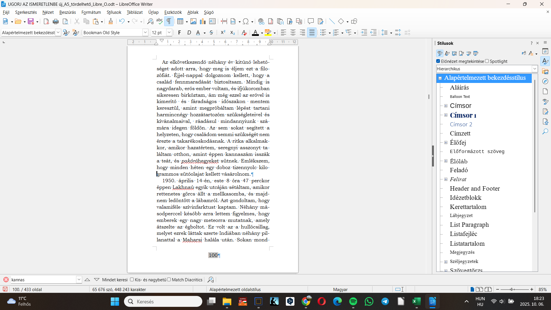

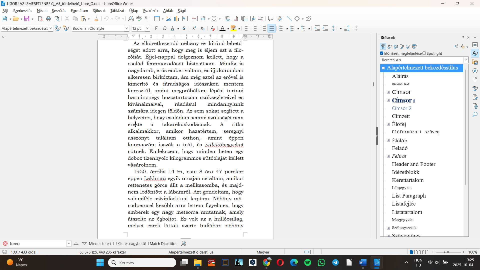

Yes, this seems to be okay. But look at the same page in the document. I’ve attached a screenshot. And I haven’t done anything to it.
OK. What should I see? Note I haven’t installed hu_HU hyphenation package; consequently, line breaks are different here.
Also, yur screenshot was taken with View>Formatting Marks disabled. (You seem to have inserted soft hyphens in several words to tag your preferred hyphenation locations)
What is the problem? How would you like it to be fixed? Give a “literary” description.
The problem is that I completed the layout, including soft hyphens etc., but the next time I opened the file, the text was reflowed. So what I see on my screen when I do the layout is somehow not the final version. And that means a lot of work for nothing.

It is like this when formatted correctly:
And it is like this after the text is reflown:

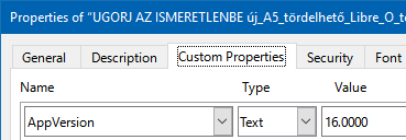

Maybe, you need to take a look at the xml code. This file was saved with Word.
