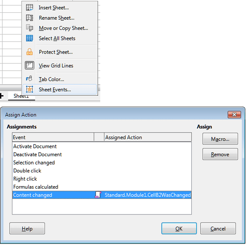

Yes, you did the right thing, but you didn’t do everything that was required. Look at the screenshot above. You need to right-click on the sheet tab, select the “Sheet events” context menu item, in the form that opens, assign this macro to the “Content changed” event. After that, there is no need to run the macro manually, this will happen automatically when any cell of this sheet is changed.
