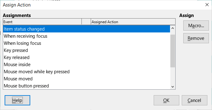

This macro should now be started by the check box.
Open the form for editing, not for input data.
Mark the check box. If it doesn’t exist create it. Right mouse click on the box and Control Properties → Events → Item Status Changed
. Click on the button with the three points and such for procedure “Copy”.
