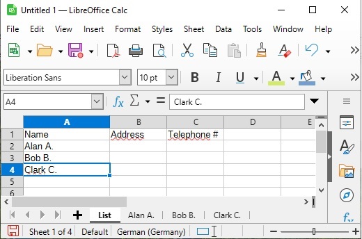

What I need to do is copy specific cells from the individual student sheets into the main list, but because there are a LOT of students, I need to automate this process somehow. Can I use the names from the List sheet as reference for the sheet names and then just give the cell numbers in question? Or is there some other trick to automate this process?

=INDIRECT("'"&A2&"'"&".A1")
See Addresses and References, Absolute and Relative
Doe.ods (8.2 KB)
:warning: it’s definitely not the way to go on the long run.
Anti-pattern - Wikipedia
would be worth investing a bit of time for example in Applying AutoFilter
