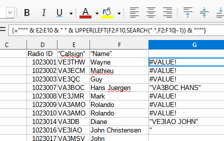

Tested this formula in a small section of my sheet. Worked correctly in one case and used data from the wrong row in an other. Resulted with a #VALUE! in most of the others.
Maybe I applied the matrix formula incorrectly ?

@robleyd already warned of lurking problems and stated: “characters prior to the first space”. The formula fails, if there is no space, so you need to give an alternative value in this case (not shown by your single example).
Why did you use a matrix-formula?

Copy @robleyd formula into g2 add three to the column references to adjust for the extra three prior columns. Do not try to add extra rows. Press enter, you should see the concatenation.
Copy the cell.
Select the cells below in the same column and paste.
[Edit 13h later in front of computer]
Search will fail for single word name
In G2 enter
=IFERROR("""" & E2 & " " & UPPER(LEFT(F2,SEARCH(" ",F2)-1)) & """",""""&E2&" "&F2&"""")
and drag or copy down
It could possibly be made shorter.
