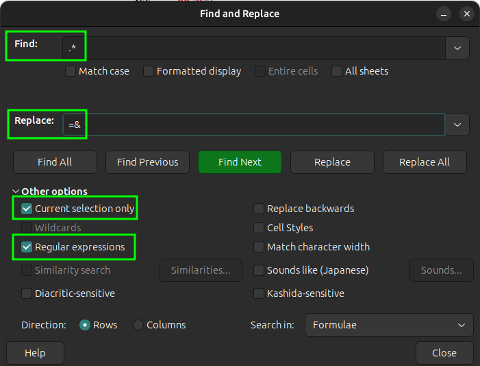

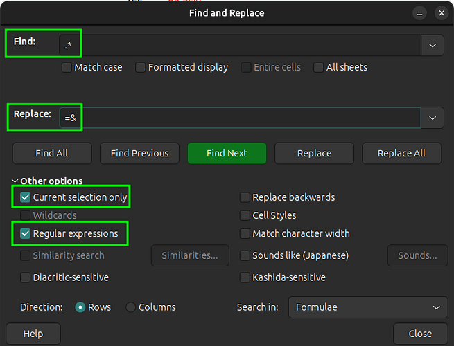

Source: [SOLVED] LibreOffice Calc: Converting Numbers From Text To Numeric
@Librescape You have seen also the unusual syntax (for Calc) the TO used to multiply three years ago? JohnSUN solved this above via SUBSTITUTE()
Yep, just thought this manual solution could also come in handy as it helped me. :slightly_smiling_face:
