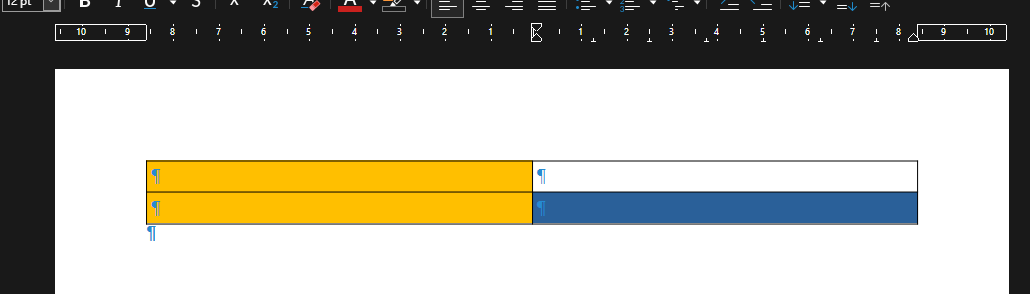

    This is how your table should look now:

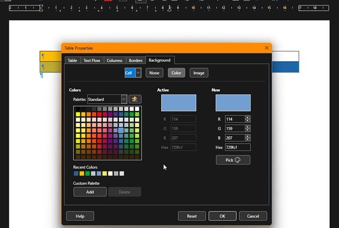

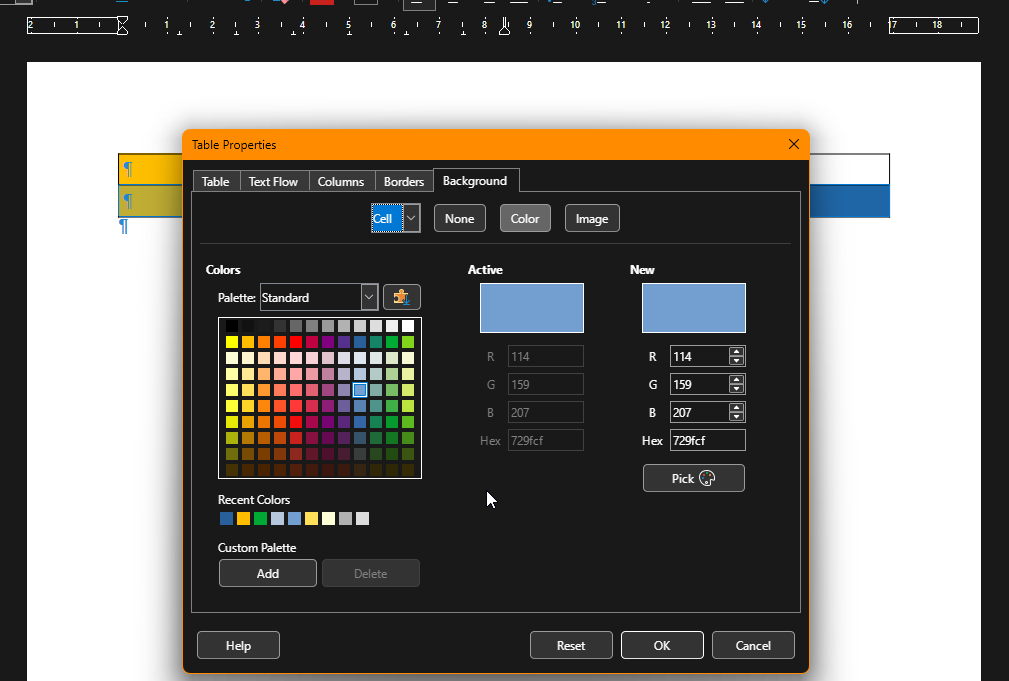

What I find unusual here is that I’m presented with this dialog:
Note how the Active and New colors aren’t any of the background colors I actually have
Suppose that all I wanted to do was change alignment, or anything else not in the Background tab.
  1. Ignore this setting and select the tab Table
  2. Change any setting, like Alignment from Automatic to Left, and click OK

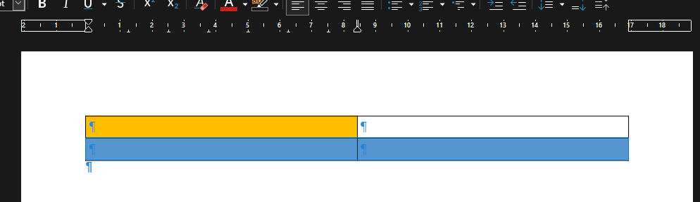

Now this is my table, which isn’t exactly what I wanted (as I intended to change only the alignment).

  3. Now, from the Table tab, change the Alignment as desired and click OK: only the alignment is changed, and background colors remain unchanged
