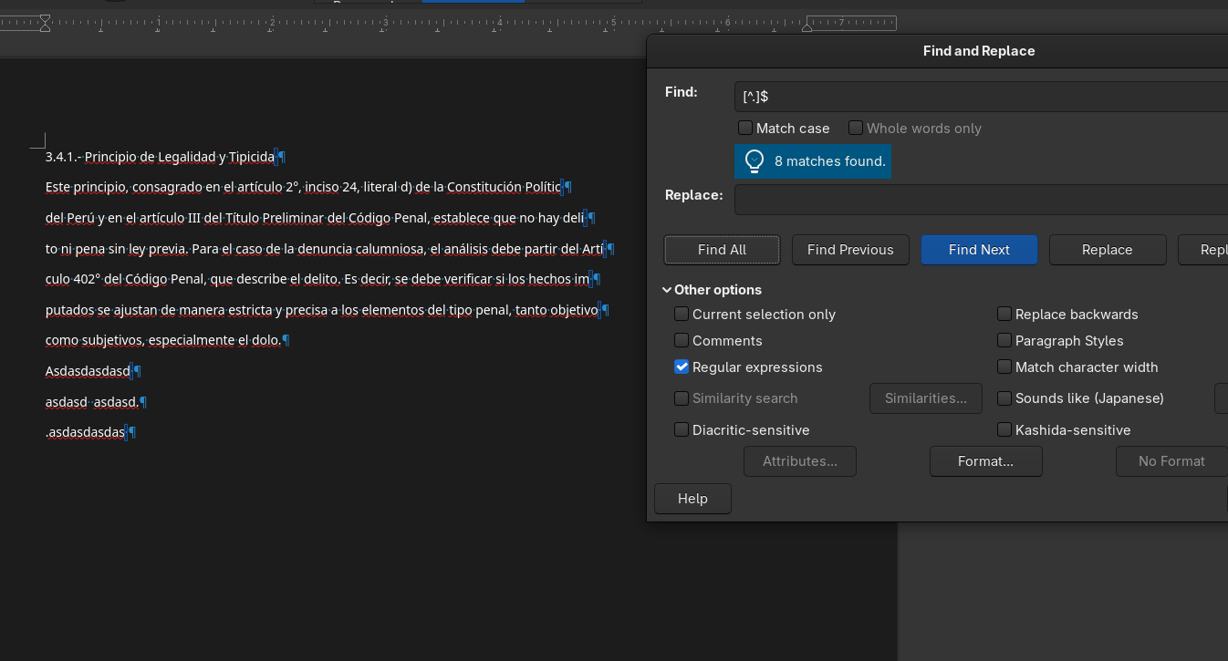

trying to remove line break except dot, but looks like find / replace detect the regex but can not replace
LO Writer regex don not work.odt (13.4 KB)
Any help?

Find: $
Edit: remove period that shouldn’t be there
Replace: Space or whatever you require.
for me do not work

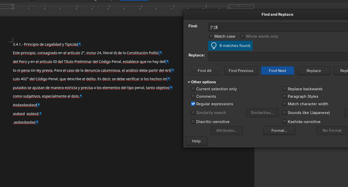

in this image the regex [^.]$ is correctly detected, but when press the replace button do nothing.
See my edit removing period (full stop) that shouldn’t be there.

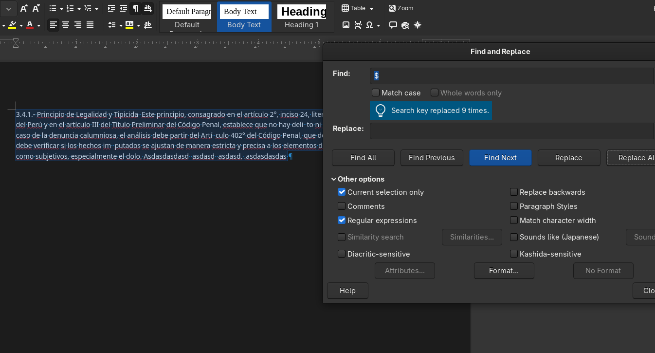

using only $ the replace work, but I need add [^.] because I need to replace all line break except when a dot is the last character
