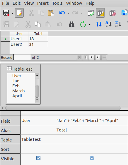

Hi, how can I add the values from a table using the query function?
Example:
 User        Jan       Feb       March   April
User1         2          5           7          4
User2         7          6           8          10
I want the total for User1 and User2 respectively.

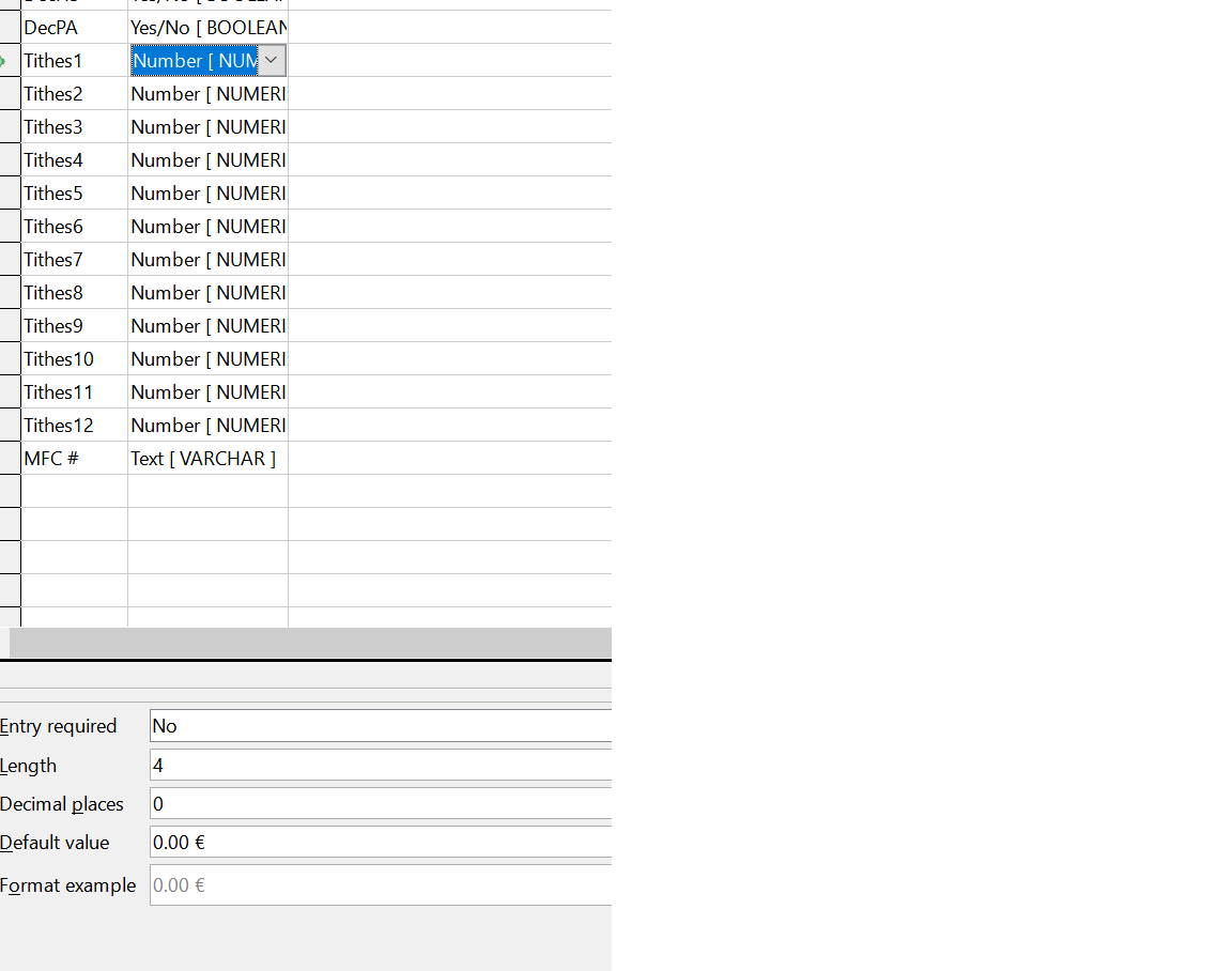

Thank you. Where can I see the the database that I am using?
I used the same formula, but the totals are not showing.
Saw it already. Yes I am using HSQLDB embedded.
By the way, the field type of fields “Jan, Feb, March and April” are NUMBER(NUMERIC).

There is no attached file in your question. Have been waiting. I was the last to edit your question on 2021-01-25
Oh sorry. I thought I’ve sent it already. Anyway, here it is. I hope it works.
@fprom,
Personally I do not use/like the Query Design mode. Has some problems and takes away from using/learnng actual SQL.
The problem you have is that you have numeric fields which contain NULL. A NULL is nothing. NULL with anything is NULL. Causes much problems. If you place zeroes in your empty “TithesXX” fields, the totals work fine.
