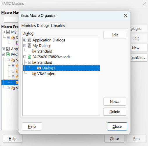

You should create a [dialog](=userform in VBA). And define macros that is different from VBA.
example
Sub ShowDialog()
      Dim oLibContainer As Object, oLib As Object
      Dim oInputStreamProvider As Object
      'Dim oDialog As Object
      Const sLibName = "Standard"
      Const sDialogName = "Dialog1"
      REM library container
      oLibContainer = DialogLibraries
      REM load the library
      oLibContainer.loadLibrary( sLibName )
      REM get library
      oLib = oLibContainer.getByName( sLibName )
      REM get input stream provider
      oInputStreamProvider = oLib.getByName( sDialogName )
      REM create dialog control
      oDialog = CreateUnoDialog( oInputStreamProvider )
      REM show the dialog
'      oDialog.execute()
  oSel = ThisComponent.getCurrentSelection
  oSheet = ThisComponent.Sheets(oSel.RangeAddress.Sheet)
  oRange = ThisComponent.getCurrentSelection()
	' code sheet -----------------------------------
	rSheet = ThisComponent.Sheets.getbyname("code")
	'msgbox rSheet.getCellByPosition(0,0).string
	rCellCursor = rSheet.createCursor()
	rCellCursor.gotoEndOfUsedArea( False )
	nLastRow = rCellCursor.getRangeAddress().EndRow
	'msgbox nLastRow
	'code sheet ------------------------------------
  aCellAddress = oRange.getCellAddress()
  nRow = aCellAddress.Row
	oTF = oDialog.GetControl("Text1")
	oTFa = oDialog.GetControl("tf_A")
	oTFb = oDialog.GetControl("tf_B")
	oTFc = oDialog.GetControl("tf_C")
	oTFd = oDialog.GetControl("tf_D")
	oTFe = oDialog.GetControl("tf_E")
	oTFf = oDialog.GetControl("tf_F")
	oTFg = oDialog.GetControl("tf_G")
	oTF.Text = nRow
	oTFa.Text = oSheet.getCellByPosition(0,nRow).string
	oTFb.Text = oSheet.getCellByPosition(1,nRow).string
	oTFc.Text = oSheet.getCellByPosition(2,nRow).string
	oTFd.Text = oSheet.getCellByPosition(3,nRow).string
	oTFe.Text = oSheet.getCellByPosition(4,nRow).string
	oTFf.Text = oSheet.getCellByPosition(5,nRow).string
	oTFg.Text = oSheet.getCellByPosition(6,nRow).string
	'oSB1 = oDialog.GetControl("SpinButton1")
	'oSB1.value = nRow
	oTimeF = oDialog.GetControl("TimeField1")
	oTimeF.text = format(Now(),"hh:mm")
	Call Combobox1_refresh
	'However, this is not sufficient to change the color
	'because by default the LibreOffice dialogs adopts the Ubuntu/Linux desktop themes.
	'The button colors remains same even if you execute above codes.
	'To solves this, you have to turn off the NativeWidgetLook property of the entire dialog.
	'Once you do that, you can change the look of the controls inside the dialog as per your needs.
	'For our example, using below code you can turn it off.
	oDialog.getPeer().setProperty( "NativeWidgetLook", False )
      oDialog.execute()
	'oB1 = oDialog1.GetControl("cbClear")
	'with oB1.getModel
  	'	.BackgroundColor=RGB(255,0,0)
	'End With
End Sub
