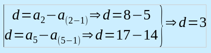

Is there a way to align vertically the drarrow d=3 in the next formula, as if the drarrow goes out of the center tip of the rbrace? This is what I get:
imagen (updated with color)
Here’s the code:
left none
 stack {
d=a sub 2 - a sub (2-1) drarrow d=8-5 #
d=a sub 5 - a sub (5-1) drarrow d=17-14
right rbrace
drarrow d=3
Thank you all in advance.

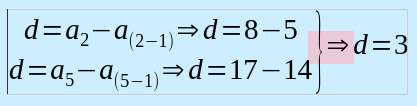

Instead of stack, use matrix and put the arrow in its own cell. Remember that Math is not a mathematical compiler but only a graphical layout utility. Consequently your formulas need not be mathematically exact. You can split your expressions to get the expected visual effect, even it is makes no sense in maths.

I see no difference.
Also tested putting drarrow d=3 in a different formula to the right of the stack/matrix. Changing top or bottom borders is a mess that can’t be undone.

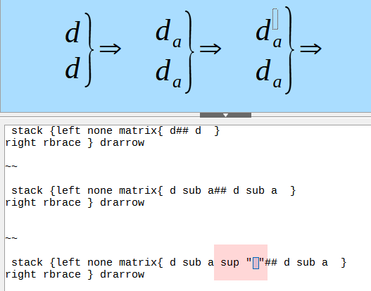

Testing with the last formula of your sample imagen, I discovered that the problem arises with the subs, so added a sup:
imagen
The zoom level also influence here.
Thanks.
Anyway, it’s no perfect.
Crazy: To space or no space, that is the big question. Good to know!
