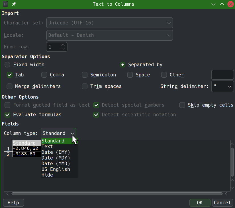

but the dialog helps in nothing to convert string to a number:
or am i still missing some button there that would do that?

Text to Columns does not allow to select locale - because you can apply locale to individual cells (or rows) before the function.

after cleaning the manual formatting, the ctrl+shift+alt+v does work perfectly (import from locale X but into locale default!)… but ONLY if you copied more than X lines… grrrrr… why??? if i have only a single value copied it just paste it there without a dialog or transformation.
PS: anyone reading this in the future, you need “[x] special numbers” in that dialog, to be able to past negative ones.
