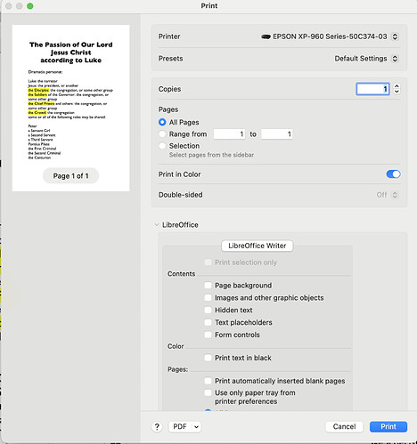

Here is the first print dialog that appears:

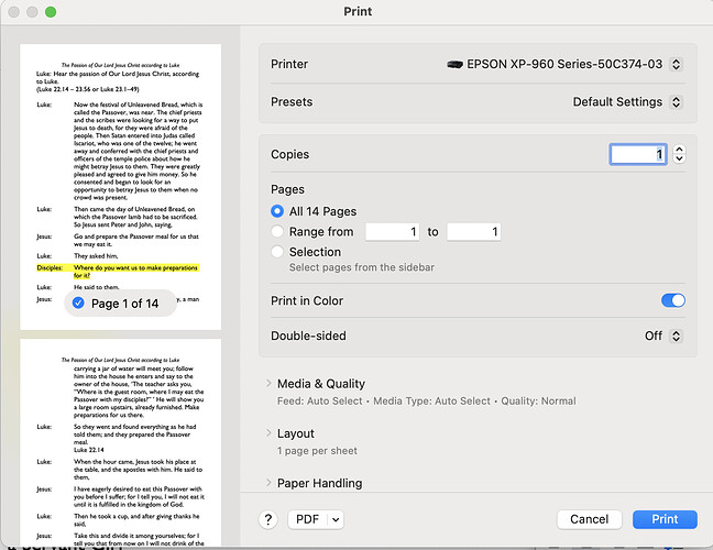

and as soon as I click ‘Print’ the first one closes, and this one automatically opens:

Very strange: the first dialog says “Page 1 of 1” and the second “Page 1 of 14” while your document definitely has 15 pages. And the pages are homogeneous: they all are Default Page Style.
