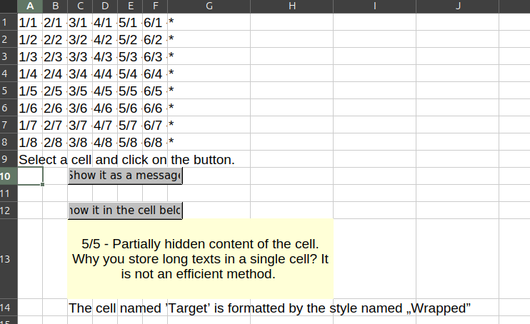

Here are two macros subroutines (embedded in the attached Calc document) for showing the textual cell content in a messaga bow ot is an another cell:
Show the long text content of a cell.ods (24.5 KB)

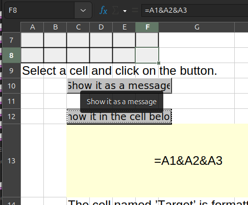

…Try to use the .Formula or the .FormulaLocal property instead of the .String property of the cells in the macros.

Here is my modified macro for the cell hidden contents (formatted by format code “;;;”.)
Show the long text content of a cell 2.ods (22.9 KB)

See my modified (and grammatically fixed) sample file.
Show the long text content of a cell 3.ods (22.9 KB)
