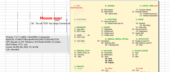

I use Comments to store usage codes, which then can be viewed when mousing over.
This worked reasonably well in OO Calc. but not so good in LO.
The only other forum discussion I found that came close to this problem was an old posting:
I read through a lot of the LO help files / Wiki stuff and this info helped me to do a good job of getting the Comments to look like I wanted. The Comments box when in edit and show modes is all good.

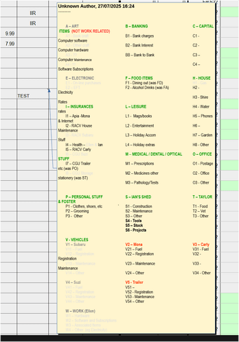

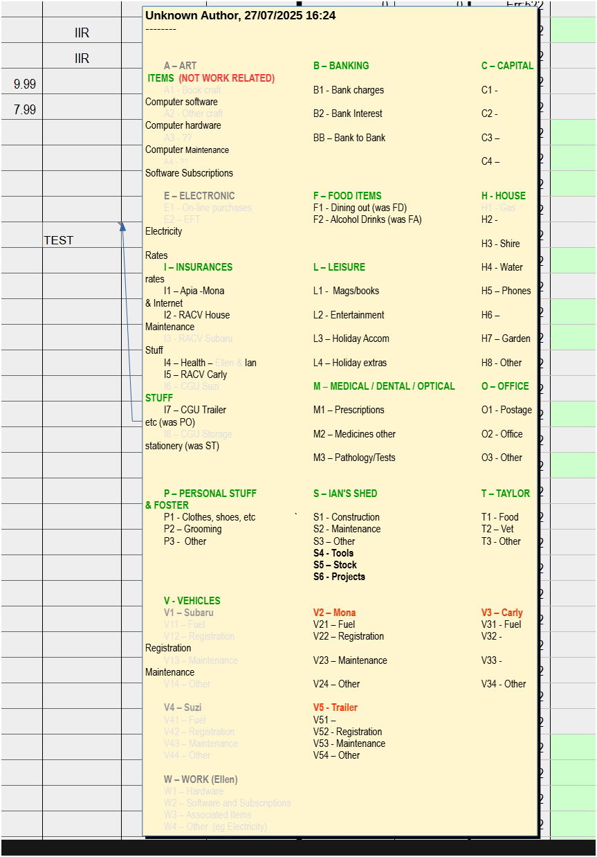

When in hidden mode and then moused-over the comments box is squashed (as below) causing lines to wrap to a new line. Makes it very difficult to use.
WHY?
If anyone can point me to an article / previous post on how to solve this, it would be appreciated.

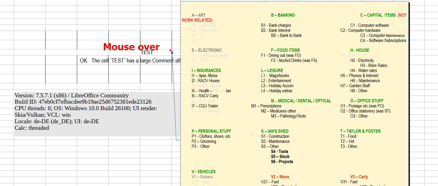

How does MouseOver on cell C6 work for you?
I simply cannnot believe you want to have all that stuff in one line.
Just tried to understand a bit better, and compared the behaviour of V 25.2.4.3 to that of V 7.5.4.2
There are obvious changes
  1. V 7 accepts and keeps changes in the width (by macro e.g.) also for hidden annotations. V 25 does not. It always sets the width automatically.
  2. On V 25 shows mandatorily Author/Date only for hidden comments with MouseOver.
I assume the changes were intentional. However, I don’t understand “2.”

The comment size problem likely is / related to tdf#158858.
tdf#73537; and search for “comment author” here on Ask.

G’day everyone. Thanks to all of you who have taken the time to respond to my problem.
I would, however, like to return to my original posting.
Paraphrased, the problem is quite simple.
  1. LO WILL let me create (in Edit mode) a Comment of any size in any format I want.
    1.1) The formatting tool works fantastically well in this Edit mode.
    1.2) NOTE: I haven’t tried locking Comment size within the formatting tool.
  2. LO WILL correctly display that Comment in Show mode. Validates the Comment formatting.
  3. LO WILL NOT correctly display the Comment in Hidden mode (ie mouseover)
SO …
  1. Has anyone played with the sample I provided? If so,
    4.1) Can you confirm 2) and 3) above?
    4.2) Is my experience reproducible on OS’s other than my Win10 / 11?
  2. Has anyone followed the last link (bug report?) provided in that 2003 discussion? ie " This is tdf#68695. "
    5.1) I’m not smart enough to understand all that’s mentioned in that report.
    5.2) I’m not even sure my problem is somehow related to that bug report.
    5.3) I can’t readily tell if that report has been actioned.
  3. Returning to Lupp’s statement:
    “1. V 7 accepts and keeps changes in the width (by macro e.g.) also for hidden annotations. V 25 does not. It always sets the width automatically.
    6.1) It seems to me that is EXACTLY what V 25 is NOT doing. In my example, it adjusts the mouseover height automatically, but not the width, thereby causing line wrapping, leading to formatting problems.
    Let’s try to work out if this is intentional (ie have I discovered the Comments box max width?) or whether V 25 isn’t re-sizing the width automatically. I’m just a Calc user - I don’t know how Calc works internally. Is this something you Calc Gurus could look into?

I have already given you the exact bug number that covers your problem. It points to the specific change that created the difference in popup processing, and even discusses the reason for that (the requirement for configurable / optional showing / hiding of the author / date, and thus changing the size of content / geometry). SO, in line with your questioning,

The relevance is: the comment - its frame - is resized, to accommodate for authorship. Yes, the discussion was, how that affected a picture in a comment; but for you, the same resize gives your effect of text not fitting into the new width.
And no, disabling authorship display (available in Calc options) will not help - the algorithm will still not keep old size then, as far as I see. Maybe that is worth of an own bug report - with a request to at least revert to fixed size when the authorship is not shown.

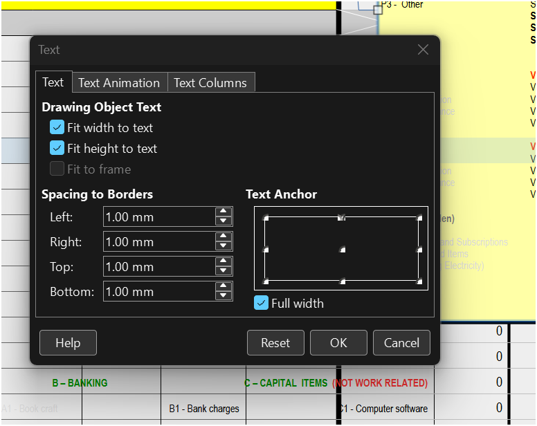

G’day again.

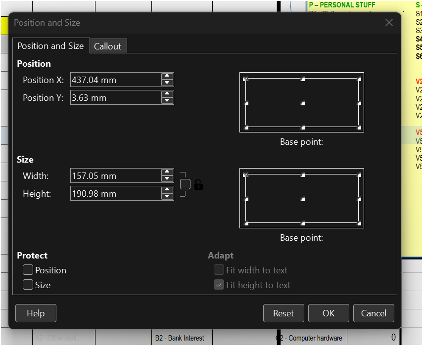

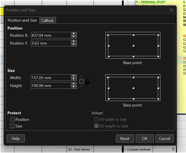

Did a bit more digging and found something in the text box editing.
Only available by right click in Show mode.
Note that the area named ‘Adapt’ is greyed out and that the ‘height’ is ticked, but not the ‘Width’.
I have no idea what this means, but to me it would be logical to have that function NOT disabled so I can tick ‘Width’.
The other thing I mentioned before is about locking the size.
Nope - didn’t make any difference.
