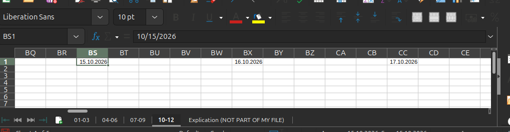

I have a spreadsheet in which the data is divided into four separate sheets, one sheet per quarter of the year. Each table on the sheet contains a date in the first column and data related to this date in the next four columns. Sometimes I receive a list of data based on which I must update, actualize the information in the sheets. I insert this list into a separate sheet and want the macro, focusing on the date in column A, to update or supplement the data in the sheet with the corresponding quarter.
Yes, I will precize. I work with Calc. Now, I have one large sheet with words I repete regulary based on speced repetition. I don´t want to use Anki etc. cause it isn´t flexible enough. The words are in Calc, column A: date when it should be learnt, for example 01.05.2025, C: the sentence,“clue” to the word or words, D: the word / words. I already have a macro that makes my approach more efficient: in row B, I write numbers of day when the word should be repeated, f. e. 5, 30…, and the macro creates sheet named 5, 30… from which I cut and paste all contents to the original sheet manually (with some additional macros). I had an idea that it would be fine to automatize also this phase. Then it would be enough to write numbers to B only.
So I considered different approach: to have four sheets, one for the three months in one year (later, they would be more but not much more, for example eight as the intervals aren´t longer that two years: here, I hope AI can efficiently help if the foundation is built). Within sheet 01-03, A1 can be 01.1.2026, E1 02.1.2026, I1 03.1.2026 and so on -three months on one sheet: the days to the first row would write manually.
The idea is that if I would run the macro on active sheet, it will search all dates in columns A1, E1, I1… (in active sheet but not in the first row) for the (maybe only future, maybe not, it isn´ crucial) dates and cut their contents (with the three rows on their right side) and paste it to “their” main columns on active or another sheet of the doc. (I deleted all manual formatting from my text.)
I have also a macro that works within one sheet (creates temp. sheets according to numbers from B, computes when exactly the words should be learned -one same date for one temp. sheet, then finds the first row in the main sheet that contains the date , pastes below so many rows as they are on the temporarily sheet - 1 (row with date), than cuts and pastes from the temp. sheet ald deletes this sheet),but I don´t think it is secure to my data. If another macro counts words in C+D before and after, the numbers differ: f.e. 30 signs but I can´t find any good explanation. It would be easier to improve this macro but the priority is to prevent any data lost so I considered to try it with more sheets instead.
As I only writes macros since three months with AI, I have no idea of how difficult it is to achieve my goals. Chat GPT wrotes macros for mne that are much complicater and that really works but here I can´t fint a solution.

The file that I promised:
Table_for_macro.ods (12.6 KB)
