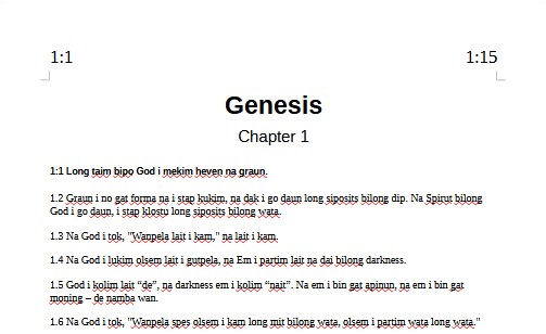

Refer using “Referenced Text” in the header. This example isn’t entirely correct because 1:1 should not appear on the first page of a chapter. But I did it to show how the next page would appear.

Bible-example-refs
Your screenshot shows a simplified layout: usually paragraphs contain several verses. Here by restricting paragraphs to single verse, you can apply some Heading n style to your verse to get automatic numbering.
It is then very easy to retrieve the first heading number in the header (please specify exactly how you want the verse number to look like in text (does it include chapter number?).
The last heading number is retrieved in the footer (mandatory). The trick is to put this field inside a text frame anchored in the footer by positioned in the header. Thus, data is retrieved in footer context but visually shows up at top.
Attach a sample file corresponding to the screenshot so that I get an idea about your document structure. A critical point is how you create the chapter heading. It is necessary that your two lines are a single paragraph and this paragraph is the very first in the page (no empty paragraph preceding it).
