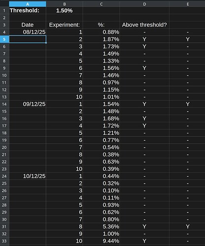

Hi,
  1. Experiments are performed over 3 days. Dates are in column A.
  2. Each day has 10 numbered experiments. Experiments’ numbers are in column B.
  3. Each experiment has outcome expressed in %. Percentages are in column C.
  4. Each experiment has threshold which is fixed for all experiments and expressed as % in cell: B2.
  5. =IF() function evaluates if experiment reached threshold or not. Outcomes are in column D.
What I’m trying to do is have a function (after googling-ing and chatGPT-ing it, it was suggested to use =COUNTIFS ), that shows ONLY the first instance when threshold was reached each day. So in the example on the screenshot I want column D to look like column E.
update: attached sample as requested :slight_smile:
Experiment_sample_2.ods (23.0 KB)

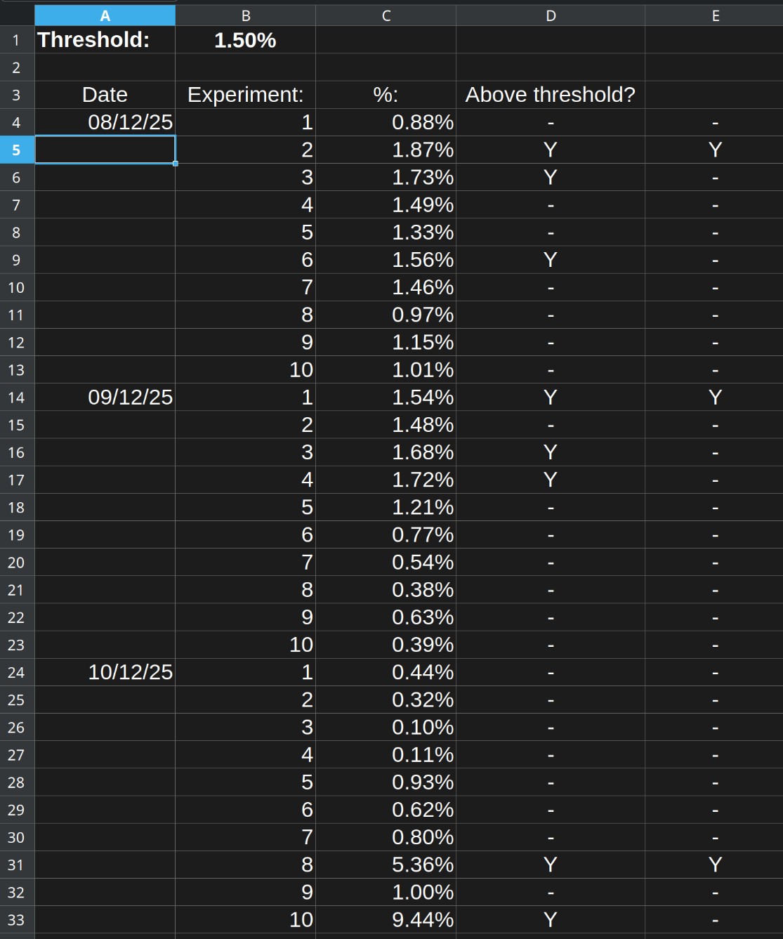

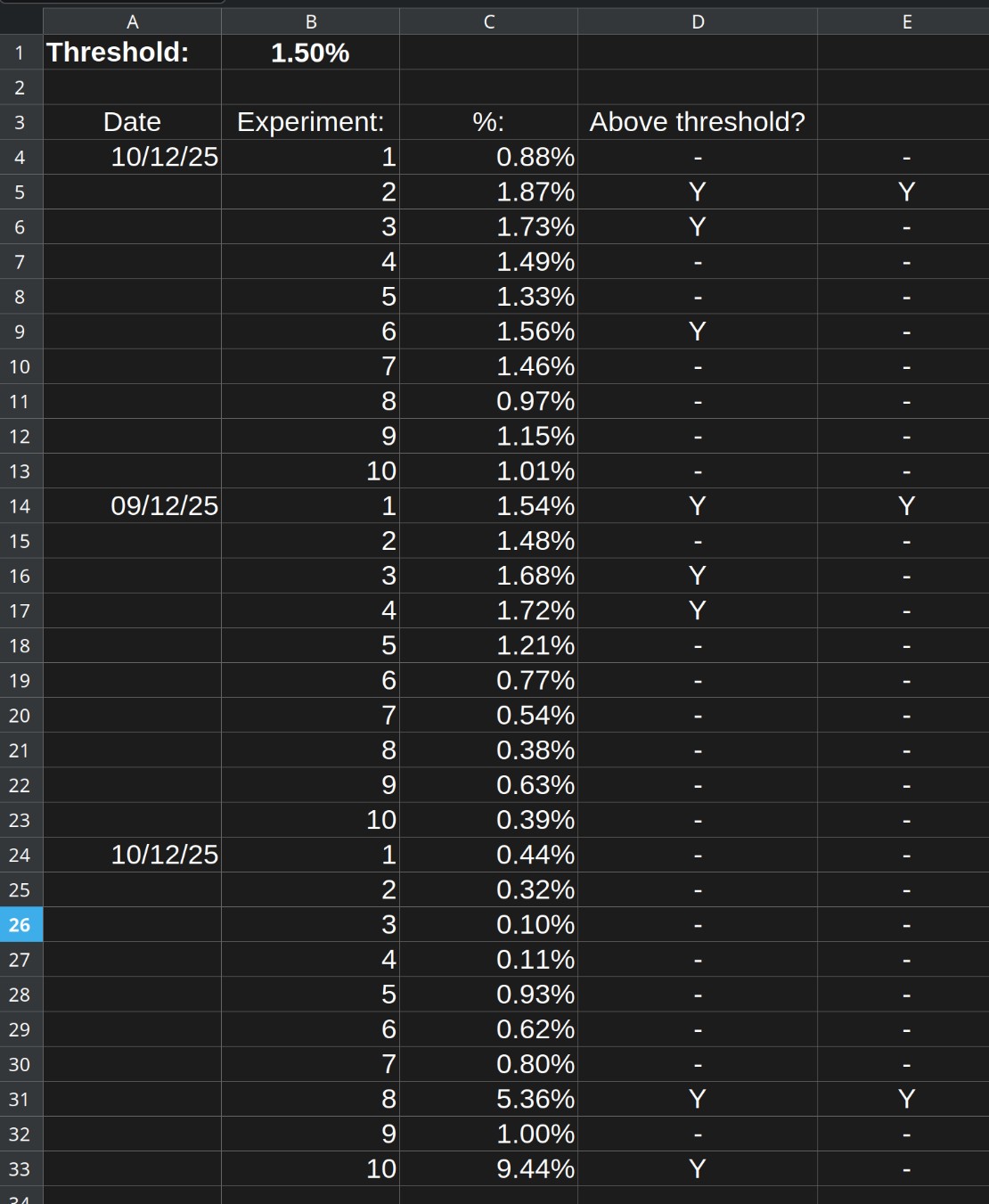

There are two problems:
    1. The Date in Column A is NOT repeated in each row until the next Date…
    1. The Date from A4 IS repeated in A24?
  1. Correct: the Date in column A is not repeated until the next Date. But I guess it can be if it would make things easier.
  2. Typo: A4 should be 08/12/25. I corrected both: screenshot and the sample.
