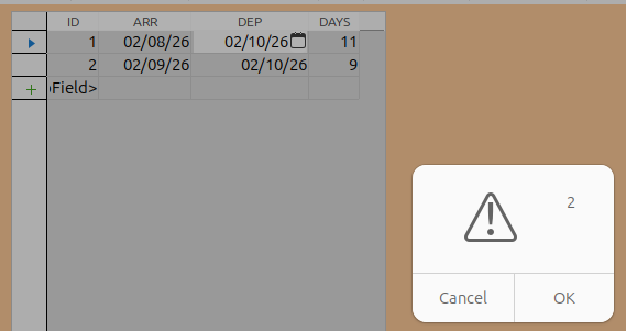

Trying to set form control along the lines of
How to update field in table with datediff result
Why I’m getting Error in
Dep = Evt.Source.Model
Event = After update DEP
If I set Dep = Evt.Source difference in days is inserted in the control, but table does not update (of course I think).
Thanks in advance!

Error_line_10

:ok: but if I just print d
instead of trying to set control DAYS (as did when testing) no problem with
Source.Model
print_d

I was able to do it via Form (TableControl Parent) .Columns.DAYS
(not Control.Model)
updateInt(d)
But it can’t come to my mind why .Model Error
in Event = AfterUpdate
and not in Event = Mouse released (click on it)
