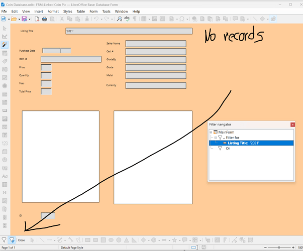

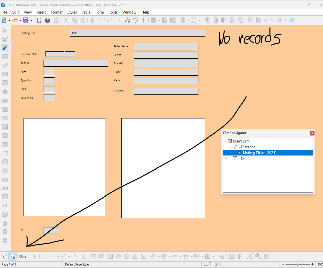

I made a form for my data (no subforms, very simple but 550 records) with a couple image link fields. I didn’t do this under query forms, its just a data form. Context: this is a database for a coin collection, mostly from ebay purchases. In a text field I enter 2021 under the ebay listing title. I have 10 records with a coin dated 2021. I tried wild card: *2021 nothing. The filter navigator pops up as shown here in the pic. NOT one record shows up! Why? I am not a SQL language person, please help. This to me should be so intuitive the way I am doing it, numerous posts on reddit of similar users with this frustration. I used AI and no help. There are no background filters blocking “2021” records from being searched. Please explain simply, as I want a form view of my record and not raw tables as in a query. Thanks.
You are editing the filter, bur not executing. Press the button left from the button, which has just been pressed. It executes the filter.

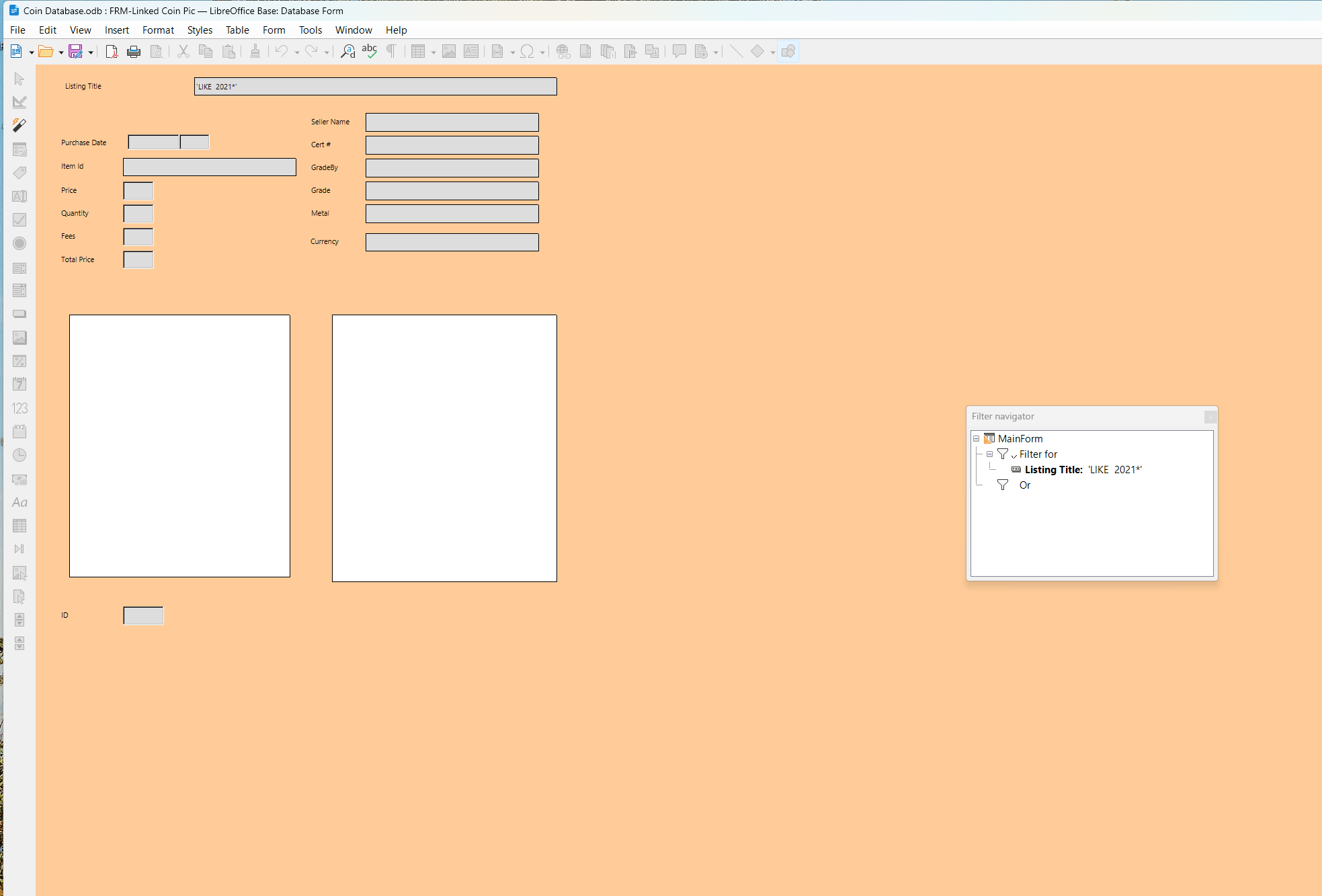

RobertG… that doesn’t work. I clicked on the icon that you were referring … lower left corner, right? I am not editing a form, you see it grayed out in the original post. I know the difference… just new to LibreOffice. Basically I want to do a search similar to searching on web page … using CTRL-F to find all records containing 2021. Thanks for replying tho!
No, doesn’t work. No records similar to the original post. Thanks for replying! Here is what I get:

Do it like this:
You could write
LIKE %2021%
OR
LIKE *2021*

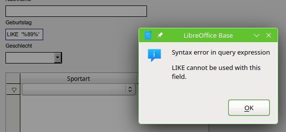

will be changed to what you could see in the screenshot.
It couldn’t be a field special for dates, because you will get an error when trying to execute the filter:
grafik

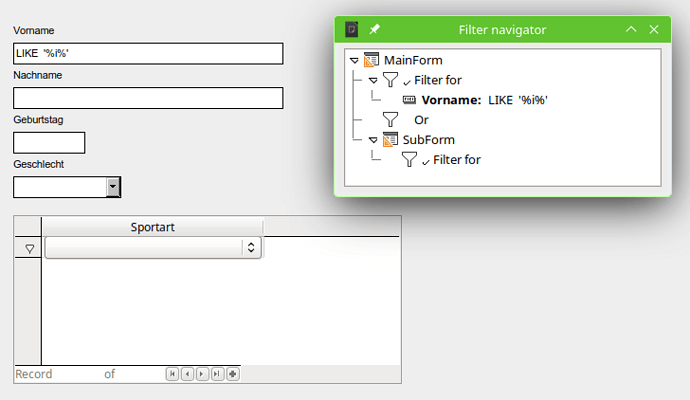

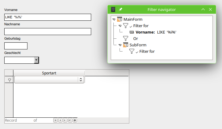

Do I need “AND” if I add a second criteria in the same field? For example 1878* AND *Morgan dollar
Try it:
LIKE %2021% AND LIKE %or%
returns all rows with ‘2021’ and ‘or’ anywhere in the string.
Entry will be changed to
LIKE '%2021%' AND '%or%'
by the GUI.

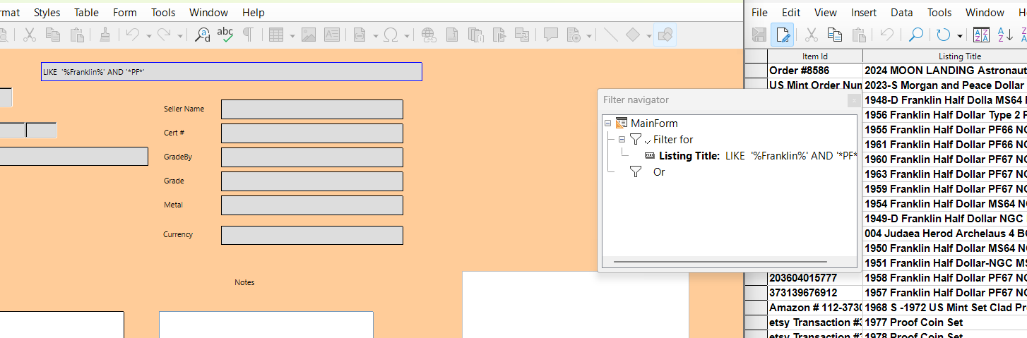

I tried to different searches, none worked. There are several Franklins and some are proof (PF) and some mint state (MS). I wanted only the PF records. You can see the table right next Filter navigator that shows the records. Nada. The other thing I don’t like, being case sensitive. Why doesn’t it take “FRANKLIN” and “Franklin” and “franklin” … sort of defeats the purpose of a database if I have to go find the record manually to see what case I typed the letters in. This is turning into a very difficult project that shouldn’t be that hard.

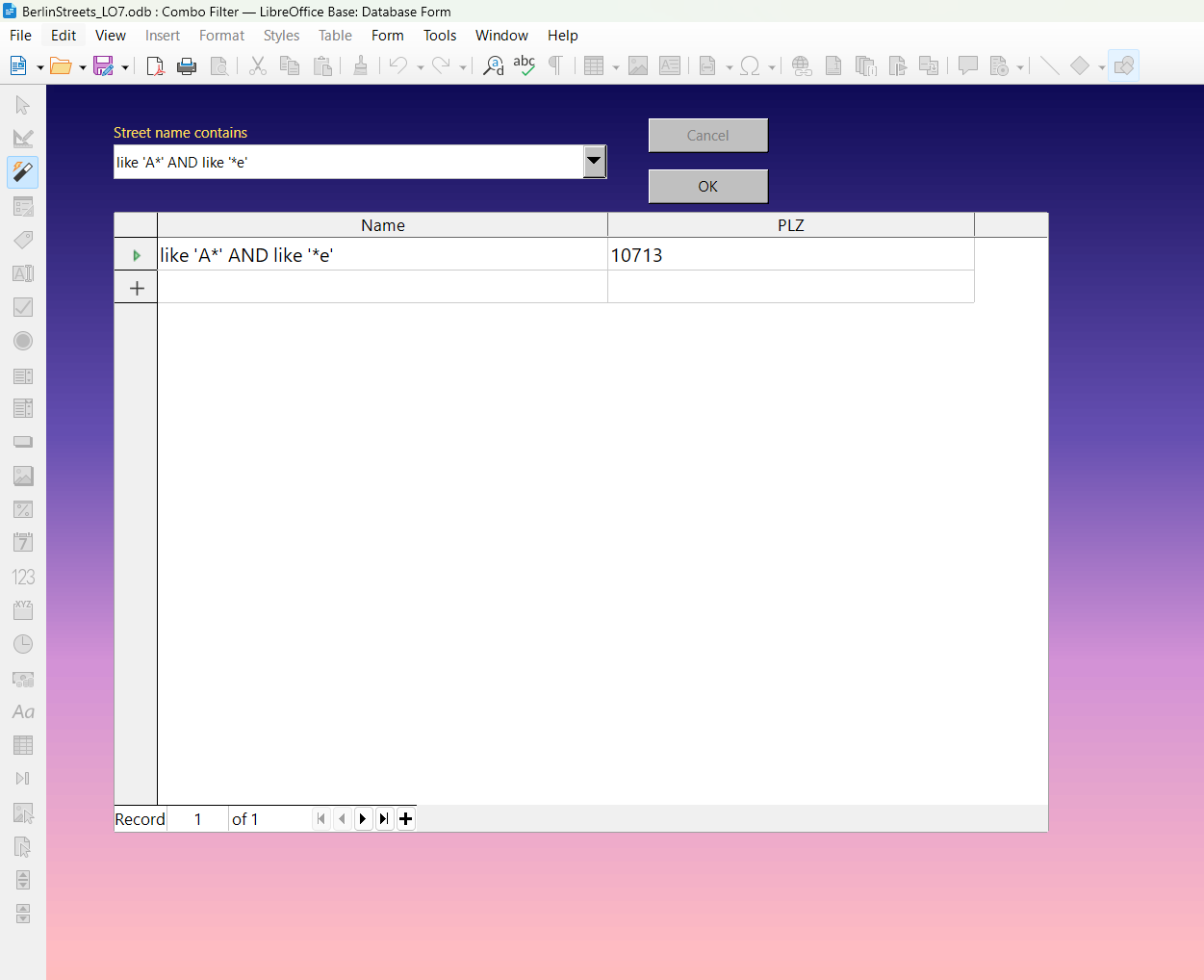

The first form “Combo Filter” is a form/subform combination where you enter a search string, click OK and the subform shows street names containing the entered search string.
  • Keep that search string in the main form empty. This shows all the records in the subform.
  • Turn on form based filter on the subform and enter: like A* and like *e (starting with upper case A, ending with lower case e).
  • Apply that filter and confirm that it works as intended.

@kculp : Have a look at the code:
LIKE '%Franklin%' AND LIKE '%PF%'
When reopening the form based filter the second LIKE has been removed and it only looks for the string ‘%PF%’ - but there is no field in “Listing Title” which only contains ‘%PF%’.
Removing the second LIKE is a bug of the form base filter.
Filed bug #170190

Sorry you are confusing me more. What is the “intended” supposed to mean? All I get is the screen below. I see some databases SQL ignores case with “ILIKE” instead of “LIKE” so I tried it. Not supported. Sad.
Thank you, I get it. Didn’t know you needed to repeat like…Appreciate your help!
Your screenshot is taken from the wrong form. Open the form “Filter String” of database document BerlinStreets_FilterMacro.odb
