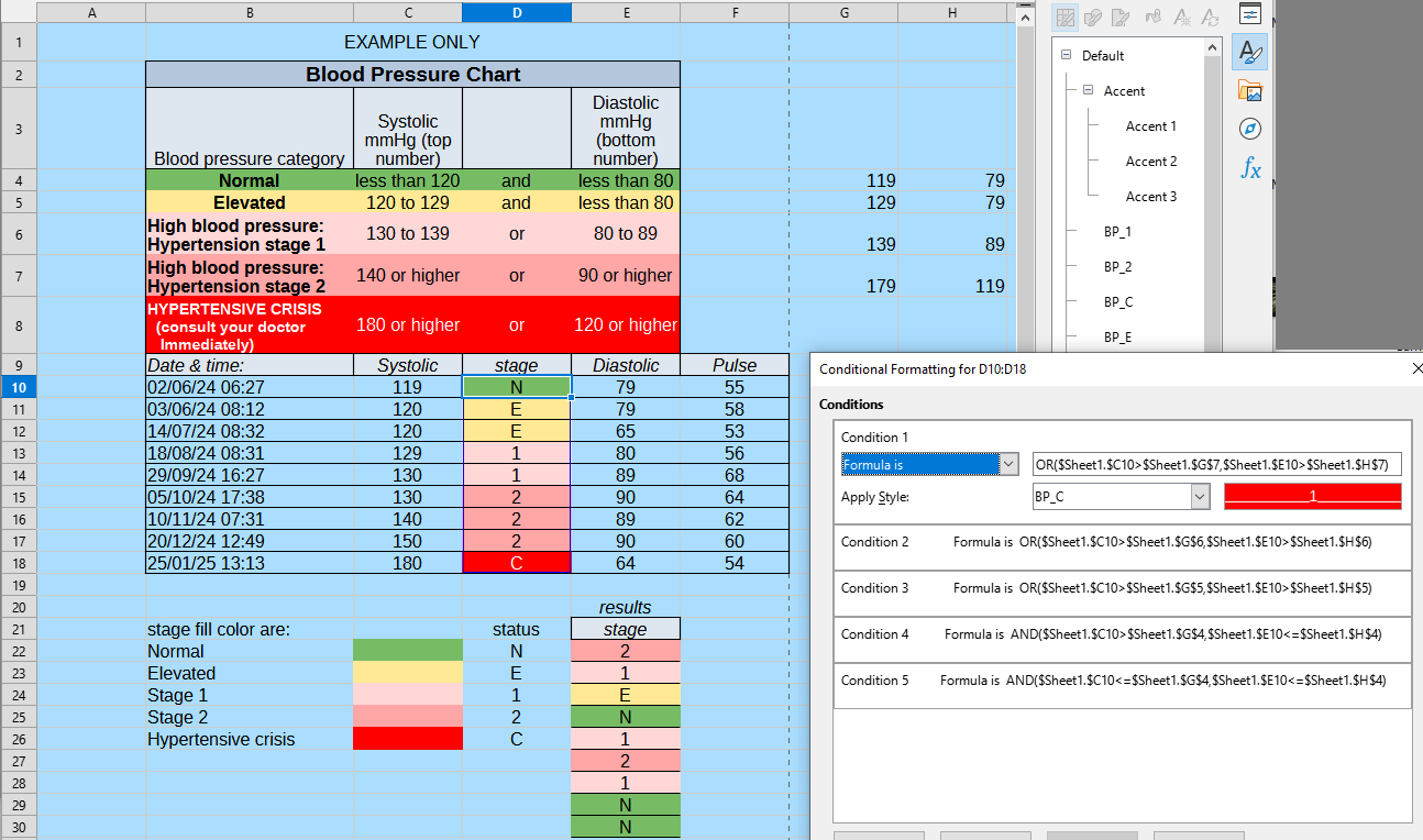

I’m trying and failing using a "between " values in setting up a conditional function.
I’m trying to get the “stage” column to be filled in based on the value in column C and E.
Is using a formula better than using “between” conditional values?
How can I set this up “correctly”?

Possible answer:
BP Sample Chart_LeroyG.ods (34.9 KB)
Cond. Formatting for C: OR($Sheet1.$C10>$Sheet1.$G$7,$Sheet1.$E10>$Sheet1.$H$7)
Each cell style add the letter for the status.
EDIT:
Values added to column G and H are used as threshold in the formula of the conditional formatting (see the $G$7, etc.).
To extend the code (N, E, 1, 2, C), add a number to each cell.

Click on the last “coded” cell (D67 in your sample file), hold Ctrl and double-click on the fill handle (the little square in the lower right corner), to fill down.
imagen
Thank you for the quick reply, I got it now. I’m very happy with the layout. :+1:
