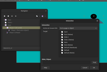

I would like to assign a Go to page or object interaction to each of shapes 9, 10, 11, 12, and 13. When I right click any one of those shapes and choose interaction from the menu, a dialog labelled “Interaction” appears with all? of my slides listed. I choose a slide and the “name?” of slide appears in the Slide/Object field. I then click OK. When the interaction dialog disappears, I right the button a just set up, and then choose execute interaction. The slide changes back to slide 1. When I inspect the Shape x (3D scene) object I tried to modify, the slide interaction is still Go to page object, but the Slide/Object field is empty.

indeed a bit weird, added an interaction on Shape 9, reopen, the page id is not displayed …
BUT it works fine in the slideshow - a workaround by itself :wink:

it works from the black circle, which is not part of a group.
the problem is with the action parameter in shapes in groups (for GotoPage, or Execute Macro). Any other simple action, like Goto first, previous, next, etc seem to work.
For (technical) reference, the href is actually empty.
 <presentation:event-listener script:event-name="dom:click" presentation:action="show" xlink:href="#" xlink:type="simple" xlink:show="embed" xlink:actuate="onRequest"/>
