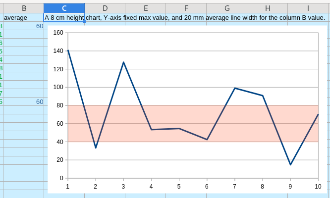

Is it possible to create a horizontal band (not the entire wall) of color on a line chart?
Is it possible to create a horizontal band (not the entire wall) of color on a line chart? If so, how. Thanks.
Please demonstrate (somehow, for example by an image) what you want to achieve really.
Just a tip: an added Graph of constant values and with thick color line?
Insert an Image as a background. See attachments.
YellowBanner.odg (11.2 KB)
HorzontalBandInLineDiagram.ods (27.1 KB)

band_LeroyG.ods (26.1 KB)
imagen
I took the end of the yarn that @cwolan left, and I found the ball.
